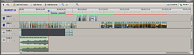

I've been double-clicking the original, long HD file and watching it in the Preview pane. Then I have been setting in-and-out points and dragging the subclips into the timeline and organizing them down there. I had no idea I could drag the subclip from the source window into the bin.
Now I've got a timeline clogged up with (I'm guessing) close to 100 subclips that I'm trying to shuffle and organize so that I can actually work on my project in the timeline too.
So I've got my project (with my song, the audio track) way on the left of the timeline and a ton of clips (organized in bunches) elsewhere on the timeline.
And I just finished color-correcting them all!
See attachment of my messed up, clogged timeline.

It didn't work for me.
Ok, I just tried setting in-and-out points in the Preview pane and dragging the subclip into my bin. This didn't work. It gave me the circle with a line through it emblem (no dice.)
So that process doesn't work either. Maybe it's because I'm using Premier Elements. Can you do this in Premier Pro?
I was really psyched about this but it seems that it won't work for me.
Will Mahoney is offline   Reply With Quote
Old May 16th, 2008, 09:00 PM   #6
Location: Brno Czech Republic
Posts: 453
Yeah, Elements are different beasts. Subclips are advanced feature, Premiere Elements is a good, but consumer, basic software.
