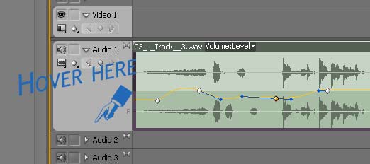

Hey Victor, I don't want to beat a dead horse, but personally, i like to go to the far left audio track, select the desired track, twirl down the arrow, and supersize the audio track to give you lots of space..
Press the P for Pen tool. You can enter desired keyframes by pressing control and left clicking. You can start manipulating the keyframes by simply dragging the points..
You can even go as far as Ctrl clicking individual keyframes to give you Bezier handles, and getting wonky results..
Lots of options my friend...
BTW, cross fading between two audio clips is Shift>Ctrl>D altogether..So long as you have the correct track on the far left selected..
cool! good pic
