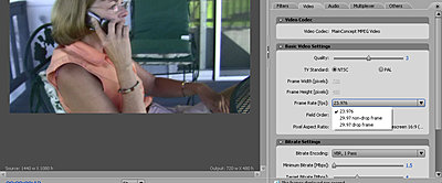

You guys know more about the A1 than I do. Although we use one for our PBS series, Painting Wild Places, I'm only the producer, and I don't know much about it. But I do teach editing software, Premiere primarily, and there have been some complaints from users about how Premiere has handled the 24p thing in the A1, and there are a few red flags that I see in the postings that don't make sense as they are written.
If the pull down was done, the timeline would be a 24 frame timeline. Earlier versions of Premiere (and I'm unclear of which versions) failed to catch the Canon flags accordingly. I don't know if this is fixed in Premiere 3.2 or not. The Forum at Adobe.com was spotty on this, too. Removing those frames would make a difference, though. The lack of 'smoothness' lies in those frames being repeated.
Making a DVD in 24P is possible, too, once the pull down is completed, and the content is de-interlaced, the Adobe Media Encoder can be invoked, and the frame rate utilized at 23.976 (for NTSC TV standards) with a Progressive Field Order.
This should make a world of difference and shouldn't cost a penny to try out.
My best.
Mike
