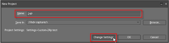

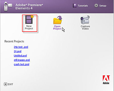

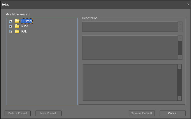

Thanks Mike, I appreciate it. How can I make a custom project file?

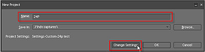

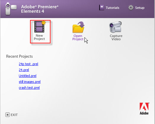

The attached photos should help, new project, new settings, custom, so on...
