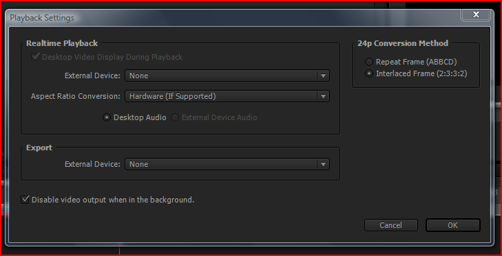

Yes, it sounds like a video card issue. Did you happen to adjust the Playback Settings to see if you could fix your issues? (attached screenshot) The Aspect Ratio Conversion and Disable Video Output look particularly intriguing.

Brian, thanks for the tip although it did not work. This is getting frustrating...
