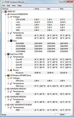

Old November 20th, 2009, 11:46 AM   #13
Posts: 1,832
These results are way too high, under the assumption that, being based in London, you are talking Centigrade, not Fahrenheit.
Idle my i7-920 overclocked to 3.6 GHz shows these results with an ambient temperature of 20 C:

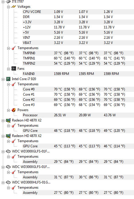

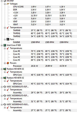

Old November 20th, 2009, 12:52 PM   #14
Location: London
Posts: 161
Here's my results Harm.
It's definetly running too hot.
I've re-installed the cooler a few times now and changed the thermal bond as well as nothings changed.
The fins still stay cool.
Syeed Ali is offline   Reply With Quote
