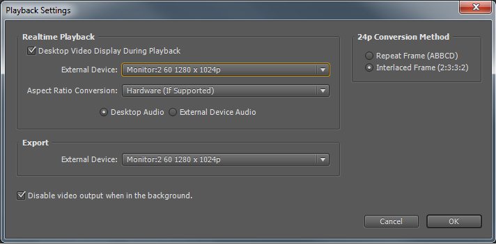

How do you setup Premiere? I'd like my Program monitor on my main Dell 24" TFT and full screen on a second 21" TFT/TV is this possible? I can only get on one or the other?

In Playback options...in the menu where you would choose "draft" or "high' quality, or switch to a waveform, etc...
In playback options, you'll see an "external device" widget...you should see any display on your system that isn't your primary display available for full screen playback use.

I think that is enabled but how do I get my "program window" over there? I can see I can undock it but I would like them on both screens?
Added pic

Ah its not working in the CineForm preset. In the standard PP ones it displays!
Cheers
Nevermind its working in CF presets now - Exited PP and opened again and it started working. Great!
