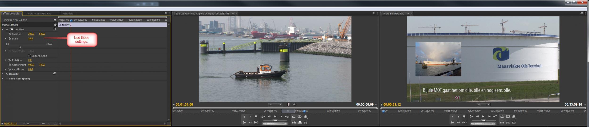

Posts: 1,832
Look at the attachment:

Old March 31st, 2010, 02:48 PM   #11
Location: Orlando, FL
Posts: 558
Bruce, if you click the attachment again, it should blow up to full size. All Harm is saying is that you simply stack the clips in the timeline, then shrink the clip on the top layer so the lower becomes visible.
