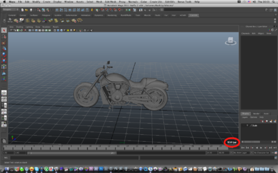

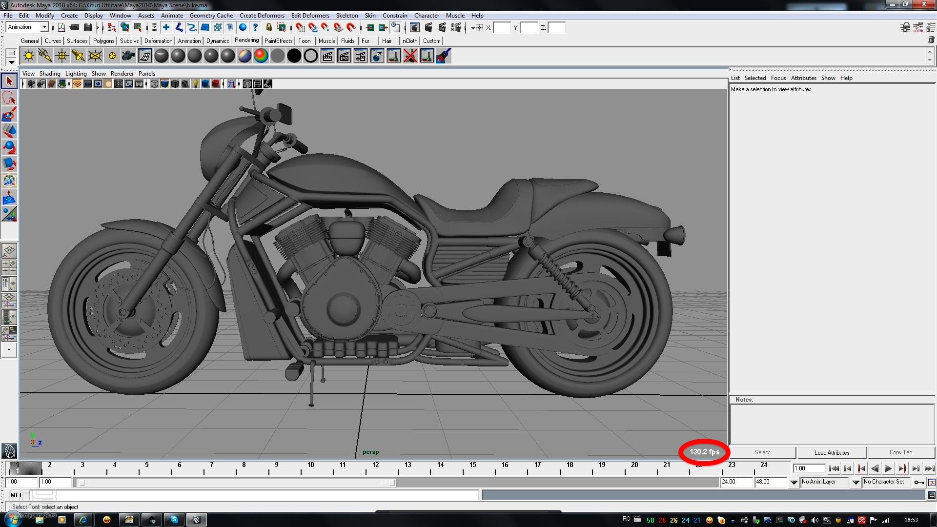

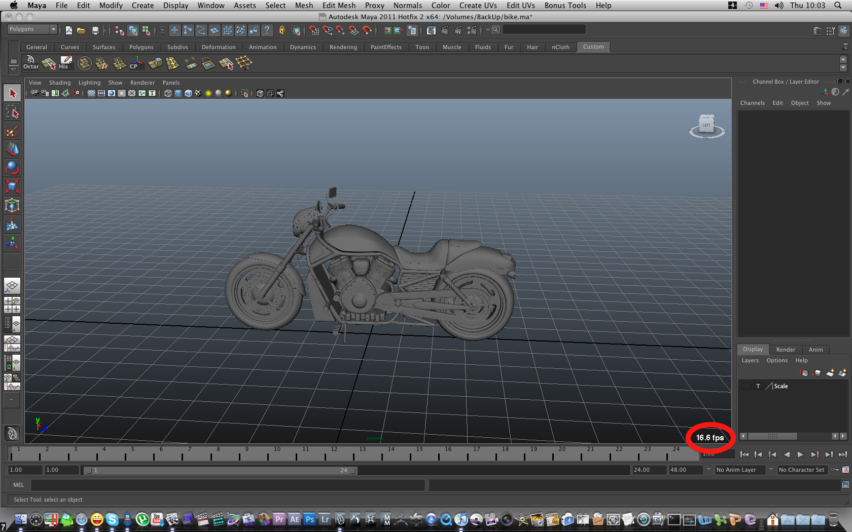

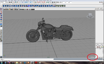

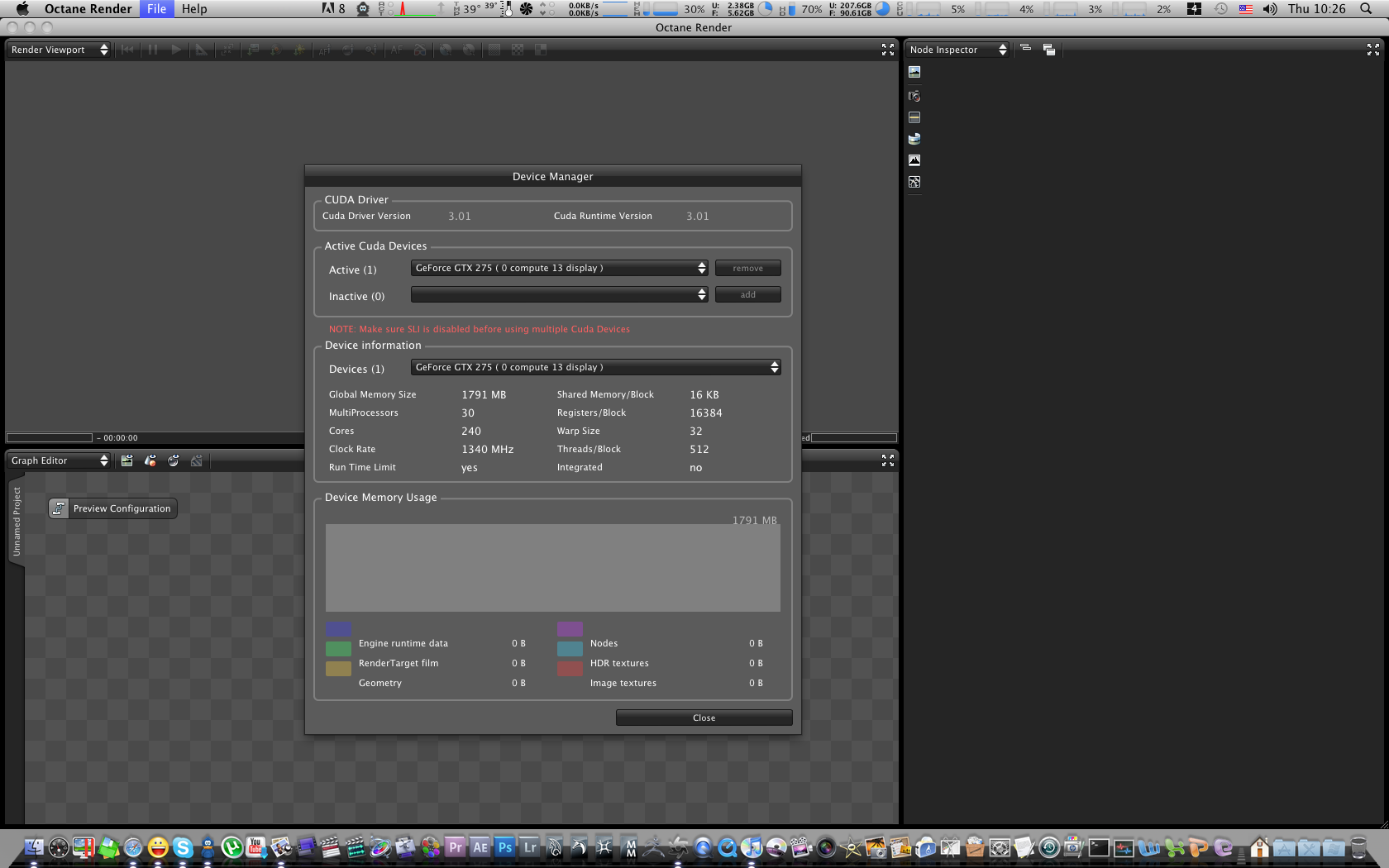

Yes Quadro FX 580 has around 500-600% more performance than my GTX 275 in most scene not all. I'm working in Autodesk Maya and render in Octane Render. All the forum recommend a FX 580 for modeling and an other GTX card in parallel for CUDA use only. Octane render has a device manager menu to select wich GPU forum the system should do the rendering. This is very convenient.
Only if some one doesn't believe me
The 16 fps screen is my GTX 275 with maya 2011 ( maya in mac os or windows have about the same performance, tested with tones of scenes)
The 32 fps screen was my old 8800GT which was bios modded to FX 3700 and used modded Quadro drivers (without the mod I had @ 15 fps)
The 130 fps screen is a FX 580 (9500GT specs) with some tweaks in nvidia contro panel from a friend of mine who had the pleasure to do a test.
Also the score from viewperf 10 and 11 was favorable for FX 580 and the numbers differences are huge.
All the test was made on a Q6600 stock clocks and P35 motherboards
And there is Octane Render device manager were you can select which card you can use for render. ( I have only a single GTX 275)
Now, how can Premiere use multiple or an other GPU from the system? It has a special menu or is enough to change CUDA txt file with the card I want to be used with premiere and premiere automatically recognize the card?
BTW: I never tested GTX 400 cards in maya but I guess the difference in performance in not that big compared to other GeForce cards, driver limitation and marketing stuff I guess.
BTW2: FX 1800 is a 9600GS with 768 MB ram and 192 bit :P 9600GT is a bit different.
BTW3: About the drivers, you can install FX 580 drivers and for GTX 275 use only Physx\CUDA drivers which is the same for Quadro or GeForce driver.
