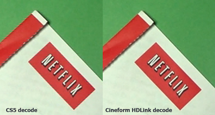

Someone asked on another forum whether the chroma bug evident in CS3 and CS4 when decoding AVCHD footage has been fixed in CS5. I had a look today and from what I can see the problem remains.
Here's a comparison of the decode produced by CS5 versus Cineform's HDLink. This is 720P24 AVCHD footage from an HMC40, converted to CineformHD avi then framegrabbed using Virtualdub. Final image enlarged 2X using 'nearest neighbour' in Photoshop - click to see it fullsize. An uncompressed bmp of this image is available at http://wildlifehealth.tennessee.edu/video/chroma.bmp (850KB).

Looks like EDIUS is still the best for native AVCHD editing. Hopefully v6 supports 10-bit color.

Out of curiosity, what am i looking for in this image?

You don't see the issues with the first image? The problem is especially evident along the outer edge of the red section in the upper left part of the pic.

Just click on the link or photos themselves. They will enlarge and you can see the difference on the red edge on the left picture.

My 7d material doens't seem to have that bug. I haven't seen it in any of my screencaps.

Oh...there we go.

The answer is yes, the problem is still present. From what I can tell, Adobe hasn't come up with an answer to this, which is unfortunate given that my camera B records in ACVHD.

I posted on this problem a while back but didn't get any responses. I guess since I didn't use the term "Chroma Bug" it didn't register. You can see the effect even more clearly here:
http://www.dvinfo.net/forum/adobe-cr...d-footage.html
I'm surprised to learn this issue has been around for a while and that Adobe didn't fix it for CS5. I use Final Cut Pro so I haven't looked into this too much, but I did run some tests and it only seems to appear with red objects against a dark background, though I wasn't always able to see the affect.

I just got a batch of AVCHD MTS files from my director, and noticed the color-fringe artifacts. Thinking quickly, I used the old mini-DV chroma trick in AE of pre-composing a copy of the footage with the blend-mode set to "color" and that layer fast-blurred vertically 2 pixels (4 works as well, not sure which is theoretically correct). IIRC, the theory in mini-DV terms was that a 4:1:1 colorspace (if I'm using the terms and ratios correctly...) spreads a single pixel of chroma info over 4 displayed pixels, and the blur smooths out the artifact.
I was pleased with the result: am I fooling myself, and is there a better fix?

For DV, that trick was dealing with a horizontal 4 pixel span (4:1:1)...AVCHD is 4:2:0...a two pixel span horizontally and vertically, so I suppose in theory, 2 pixels would be enough.
However, whatever looks best to you is probably the way to go...

Andrew - thanks for the post. The "better fix" is to apply a different decoder to the AVCHD footage, for example ffdshow through an avisynth script. But life is too short, really, to do that regularly ....
