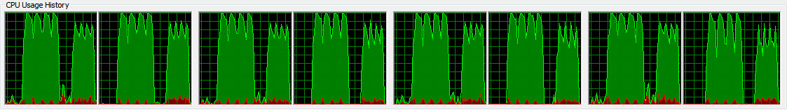

Multi-threading is not the issue here. In fact the multi-threading with H.264 is very good. Look at the attached image. The first block is with software MPE and the second block is the hardware MPE.
The problem with dual processors is that they cause a lot a latency with inter processor communication, as explained in the background information page. I suggest you read the Interpretation page and the Background page carefully. http://ppbm5.com/index.html
Core i7 - 6 core versus 4 core performance with Premiere CS5-12-8-2010-14-21-05.jpg
