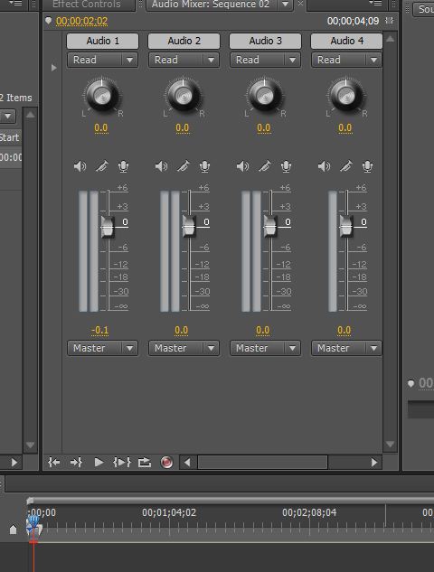

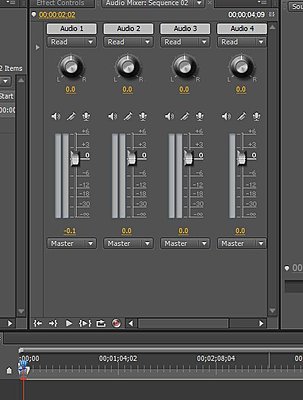

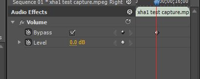

If none of your Windows sound control panel controls show a volume turned too low, try opening the audio control panel in PPro and taking a look to see if you have inadvertantly muted or altered a channel (see clip). Right click on the audio track and select "remove effects" to get rid of anything oddity that might have crept into the audio track...you can see what you have on your track in the effects window (second clip)
Since you indicate this is a problem you experience upon importing the file, and also on export, it must be some setting that is confusing the issue, assuming your clip plays normally in another player...like vlc or quicktime?
Audio Frustrations in Premiere CS5-amixer.jpg   Audio Frustrations in Premiere CS5-bypass.jpg
