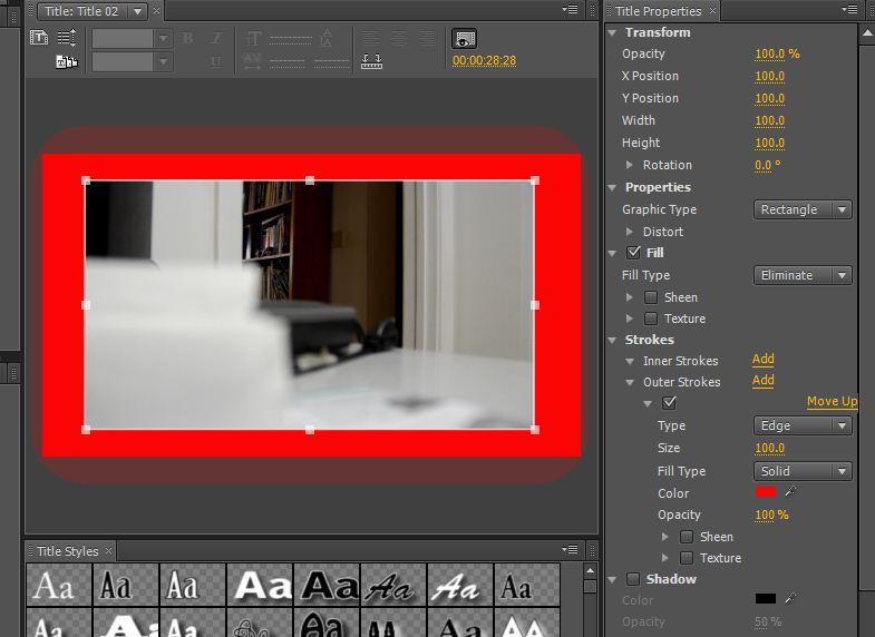

Totally flying blind here, as I have CS4 and can't identify the tool you're speaking of, but here is a possible workaround: CS5 still has the crop tool, according to the cs5 help file. So crop. In Titler, make a rectangular box covering the video image you just cropped. Select "eliminate" in the type popup. In the stroke field, select Outer>add; select color in the color swatch and make the size to cover the frame outside the video image. See attached jpeg.....
Sounds like there must be an easier way....and forgive me if I have misinterpreted what it is you're trying to do...

If Battle's image is the look you are looking for, then the simplest suggestion would be to add a sold colour matte on the lower track, with the footage above it. Then simply crop or scale down the footage.

Make sure you untick scale and set it manually because it does not make a perfect even boarder.
Then nest the two images and motion, scale or rotate as much as you like.
