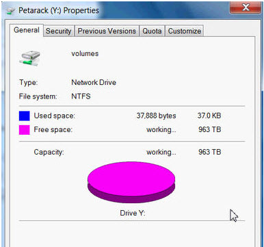

Maybe I misunderstood, but it seems you are out of disks and out of disk space. A disk filled more than 60% rapidly deteriorates in performance and at 85% fill rate is about 50% slower than when filled below 50%. Maybe it is time to have a look at some extra storage space. I have the exact address for you:
One Petabyte (1PB) in a Rack
Notice the 963 TB space. That should suffice for now.
