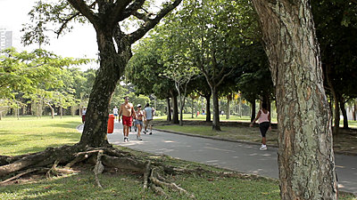

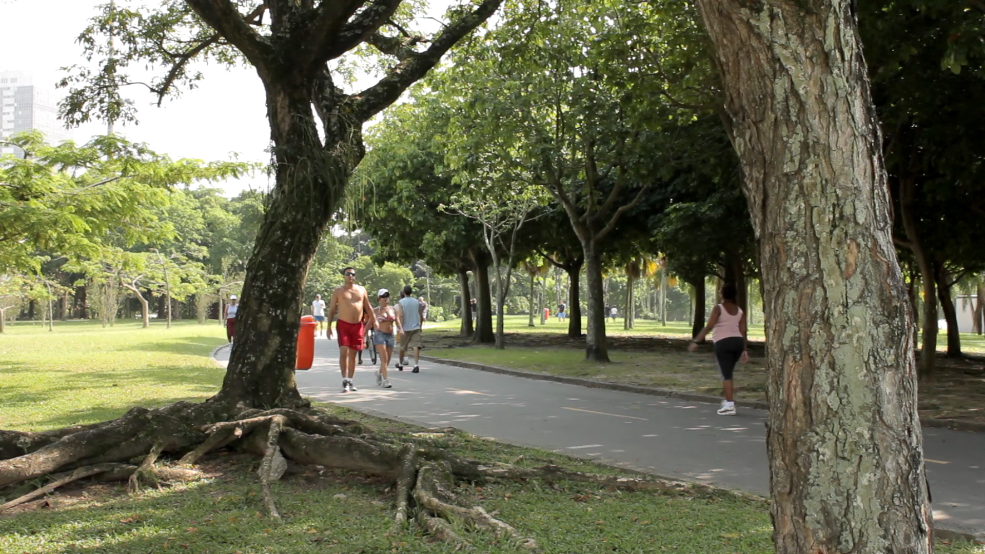

Yes, if I understood what you said, my first post state: "The difference in "image darkness" between Vegas pro 9.e and PP5.5 rendered files, reproduced (after imported) in both Vegas and PP5.5 preview windows kept happening."
I attached two snapshots (JPEG) from a AVI file, almost the same frame, one rendered in Vegas 9.e and the other one in PP 5.5. Maybe the difference in gama is a bit minor than it would be if from a QT rendered file, but it`s there.
Anyway, if this gama shift happens with a QT in Premiere, it`s a BIG limitation of the software, because nowadays many codecs used by most filmakers / videomakers are from Quicktime .
Mystery: PP5.5 (darker) file reading-premiere-snapshot-avi.jpg   Mystery: PP5.5 (darker) file reading-vegas-snapshot-avi.jpg

Agreed that QT has severe limitations and that is why many avoid it like the plague. Not only the gamma shift, but the major drawback is its 32 bit nature, completely destroying the attractiveness of 64 bit NLE's and making for much slower encodes.

One thing to keep in mind is that PPro uses Full Range RGB (i.e. when converting YUV422 to/from RGB444).
To my knowledge, Vegas uses SMPTE Range RGB for it's first two Pixel Project Formats (i.e 8-bit and 32-bit Video Level) but Vegas uses Full Range RGB for the third Pixel Project Format (i.e. 32-bit Full Range).
So that could be one of the differences you're seeing with importing/exporting files in Vegas or PPro. ( I don't have Vegas 9 here though)
Also- when you import/export to/from DNxHD MOV files - they also have their own Color Level Setting embedded in the MOV file wrapper - either '601/709' Color Level (i.e .SMPTE RGB) or 'Computer RGB' (Full Range RGB) - and that embedded Color Level Setting in the DNxHD MOV file will determine whether the Avid QT Codecs decode/encode DNxHD to/from either SMPTE Range RGB or Full Range RGB.
Hope the above helps!

Here is part of the problem:
Your H.264 originals from that DSLR have already had the MOV container around them. Thus, if you try to edit "natively", QuickTime (or "QuiRckTime", as Harm puts it) will be automatically invoked, slowing down the process significantly. The only way to avoid this would be to somehow remove the MOV container through a third-party application without invoking "QuiRckTime".
The other problem is that your Vegas-processed shots are a bit dull. That's because Vegas (at least through version 9.0e) does not natively handle any color space other than 4:4:4 RGB. Therefore, 4:2:0 and 4:2:2 YV content gets converted to 4:4:4 RGB within the editor. And each color space conversion degrades color quality and/or raises the gamma level up to unnaturally high levels (very weak, gray blacks and washed-out whites). And then, "QuiRckTime" brings that gamma back down to "normal" - but some of the color information would have already been lost by then.

No Randall, my system is ok, I gess. The operation with Premiere runs quick and the preview is very stable, at least with a not too long timeline and with 3 effects tracks. The render process with PP 5.5 is at least 35% faster than with Vegas.
The main problem is this gama shift.
I has just tested a render to MJPEG A (QT) and the gama shift aparentlly inverted! I mean, Vegas render had its blacks darker, and the Premiere render a litle more washed out overall. Crazy, isn`t it?
But I tend to agree with your opinion on the Vegas behavior - very weak, gray blacks and washed-out whites.
