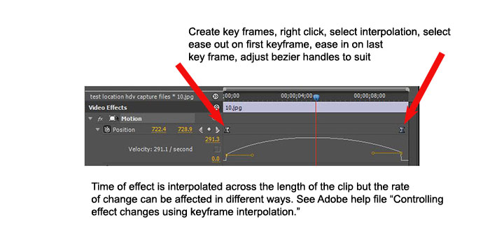

This can make your start and finish smoother. The actual duration of the pan is set by the distance between your beginning and ending position keyframes. Obviously, the upper limit is the duration of the clip. Generally, you set the pan to begin about a half second or so after the start of the clip so that the effect is not "sudden" to the viewer, and leave a small time at the end of the clip similarly. The rate of change is most easly handled by the "ease out" and "ease in" choices, which vary the rate of change in a smooth way. "Ease out" is used first -- think of a train easing out of the station and getting up to speed, if it helps remember which effect is which. Ease in is the opposite effect.
The mpg attached is the result of the curve shown. For making the file small enough to attach it's converted to NTSC DV, so there are scan lines, you wouldn't want to do that with your own file, probably.

This is great thank you.
