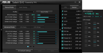

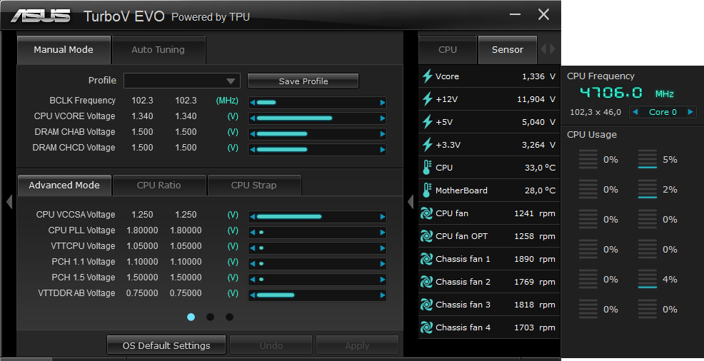

Going from 1.25V to 1.375V is a huge difference. Clearly 1.25V is pretty low for an overclocked system (depending on the multiplier and BCLK settings) but upping that to 1.375V is huge.
In my case, with the same CPU, using a multiplier of 46 and a BCLK of 102.3 resulting in slightly over 4.7 GHz, I use a CPU VCORE voltage of 1.340V. That gives me an idle temperature of the CPU of around 33° C and under heavy load of around 58° C and under Prime 95 stress testing around 67° C after one hour of testing with ambient temperature of 21° C. Note that my GTX 680 is also overclocked from 192 GB/s bandwidth to 226.8 GB/s, so that adds some heat to the system, although the GPU runs at around 34° C idle and around 59° C during stress testing. Additionally my 64 GB memory runs at 2182.
