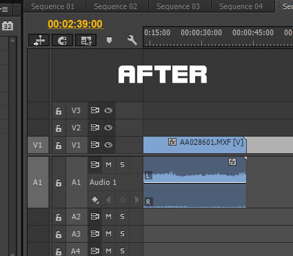

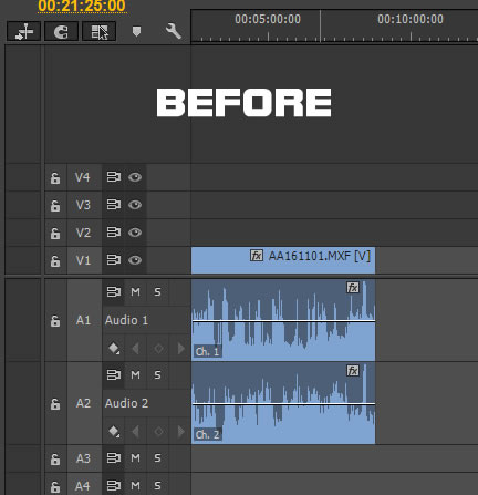

Before, two separate channels of audio would be on the timeline (A1 & A2) when I moved it from the project window.
Now, both channels are in A1 and I can't figure out how to get it back to the old way.
Files are MXF
Properties are:
Source Audio Format: 48000 Hz - 16 bit - Stereo
Project Audio Format: 48000 Hz - 32 bit floating point - Stereo
Screenshots below
Premiere Pro CC - How to get 2 separate channels on timeline-before.jpg   Premiere Pro CC - How to get 2 separate channels on timeline-after.jpg

No it's not that.
I think it has something to do with the way Premiere is importing the audio files. I've tried various options in PREFERENCES > AUDIO but nothing seems to work.

This usually works for me:
-Right click on your footage in the project window
-Go to Modify -> Audio Channels
-Set channel format to Mono
-Set number of audio tracks to 2
Then drag that footage into a sequence and it should have 2 audio tracks.
You can also go to edit -> preferences -> audio and change the Stereo Media option to Mono. That should force files with stereo audio onto 2 tracks for any footage that you import in the future, don't think it'll affect footage already in the project.
