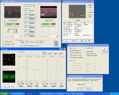

You may wish to try our Enosoft DV Processor. It does exactly what you want - i.e., you can correct white balance, phase etc etc in real time during the capture process....It has a waveform monitor, vectorscope etc. It works on live DV sources as well as precaptured files. It can also work from one DV device to another without having to capture anything.
I downloaded it, but it is just a capture software. Where is the waveform monitor, vectroscope, etc? There are not any correction options there.
Please look at the Help file provided (version 0.18). When you open the file, you will see a screen shot. In the lower part is the "Proc Amp" and it shows the waveform monitor and vectorscope. You can click on the picture in the Help file to take you to the more detailed explanation of the Proc Amp.
