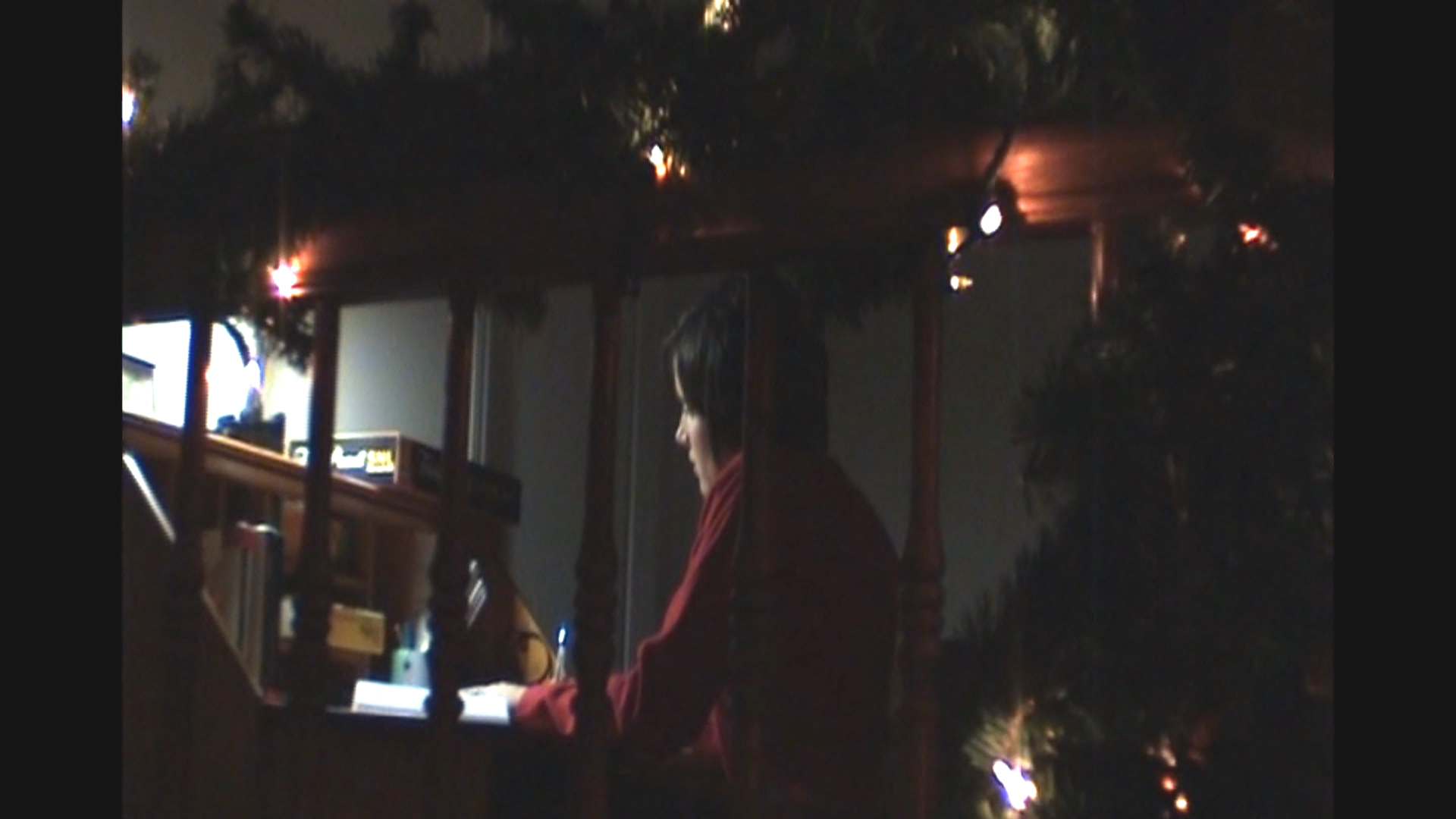

I filmed this clip, and as usual... it came out very dark. I'm using a small handheld Sony camcorder.
http://files.filefront.com//;6352260;;/
Yes, I really need to work on my lighting. This was shot with no special lighting, and you can tell.
I do want it to be dark... but it just looks a little grainy, and the colors are off.
Is there any way that I can work with what I have? Any way of improving the image during post?
I've added "auto color" to this clip but it was too severe so I had to blend it with the original stock. About 75% original, 25% auto color.
Any tips on making this look better? I'm using PPro 1.5

So I took your clip, put it on my Premiere Pro 2 line, adjusted just contrast and brightness a bit, and captured this result. It does show clearly that there is detail in the clip to work with and that a bit of hard work will do the trick.

I would just use the Levels effect, setting the top end at a bit less than maximum.

WOW! Thanks Chris... that does help.
You see how the blue on the top of the pen (she is holding) is blooming, I believe it is from the auto color.
I guess it would be better to use the color corrector.
I'm just so bad at it and I usually screw it up.
Any tips on what I should adjust with that?

I believe that Levels was in Premiere Pro 1.5, I use version 2.0 though.
If it is not in 1.5 then it is certainly in After Effects. Don't use the auto levels. Just Levels.

I have it... one last thing?
What do I change?
There are many black, white, gamma levels. The whites seem to be at 255, the blacks at 0, and the gamma is at 100.
Should I just drop them all slightly?
Edit: Seems like dropping the white RGB input level helps, so does boosting the gamma.
Which one would be better to use?

Start by taking the whites to 150 or so and see how you feel. I don't think the other settings really need much work.

150 really makes it look grainy but you are definitely on the right track. I think I'll drop it to 220 or so and get the results I'm looking for.
A little brighter, a little more detail, but still dark.
I hate the noise that you get with this thing as things get brighter. I guess you have to try and find that fine line...

Try a very slight fast blur. Maybe a pixel or two.

Thanks Steve, I went with the blur (1 pixel) and the levels adjustment.
It's really looking better now.
Thanks to Chris as well... I might further tweak with the contrast and brightness a tad more.
