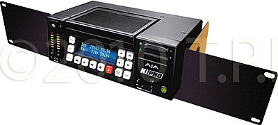

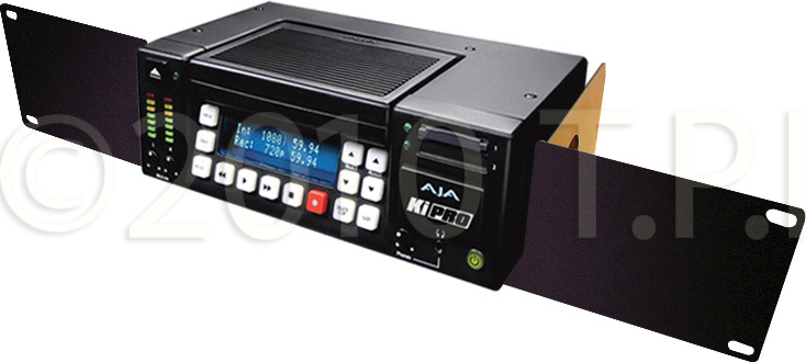

We're looking to rackmount a Ki Pro into a Gator road case for travel. It needs to be screwed down tight. I finally found what we've been looking for. It's made by Connectronics
Guy Cochran
