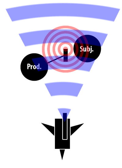

Old October 6th, 2007, 03:01 PM   #13
Location: Austin, TX
Posts: 773
I would agree, except that I did test it out in the store, sounded fine. I'm pretty sure that I can get rid of the stereo issues by simply putting it through left-channel-only. Right channel will be the shotgun, which I prefer except that I'm afraid the shotgun will pick up too much background noise.
Alternatively, I could simply mic both of us up with wired lavs, but I'm afraid that the wired lavs would pick up too much background noise (it's a VERY noisy environment), that they'd be a PITA to take on and off (I'll be running from one booth to the next pretty quickly.) and they don't handle situation where there's more than one interviewee. Really, I should do this with a camera operator and a sound engineer, but I don't have one. It's just me.
Brian Boyko is offline   Reply With Quote
Old October 6th, 2007, 03:14 PM   #14
Join Date: Mar 2005
Posts: 5,742
Your camera has only one external mic jack. How are you going to plug a stereo mic PLUS a shotgun into it at the same time? Using a "Y" cable won't do it.
Old October 6th, 2007, 05:31 PM   #15
Posts: 773
You sure?
Let me try it.
Damn, you're right. (Works fine up until the point I plug in a second microphone.)
There's always plan B - use only the stereo microphone and downmix to Mono in post.
