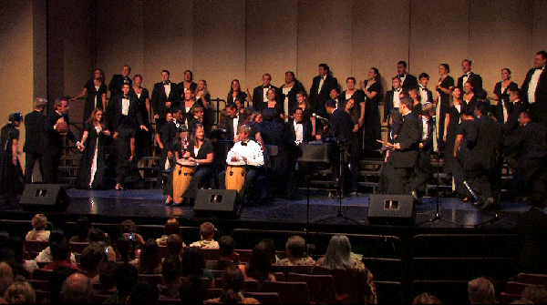

Ok, so here's a slightly wide shot of the auditorium I was shooting in. I'd figure I was about 40-50 yards away from the stage. The House Sound Board was about 30 feet behind and to the left of me.
Again, the A1's audio turned out to be decent, but I'm no audiophile, and I know it could be better.
I'm wondering, what are some options for getting the best audio in the following situations:
1. Hooking into the House Sound Board. Should I hook up to the sound board via a wireless transmitter, or a hard line?
2. Setting up an additional mic or recorder (like a Zoom H2) up on the stage and perhaps sending it to the camera via wireless transmitter. What are your suggestions here?
3. Any other ideas you may have.
FYI - I'm just a student doing this as a hobby. I still plan to invest around $500 in some decent audio equipment, so your advice for that price range would be most appreciated.
Thanks for all your comments! I love this forum!

Wired is better than wireless in virtually all circumstances - except when you can't run wire or need more mobility than wired gives you.
The sound board should be a good source, if they know how to do a good sound mix. But getting a good mix is by no means assured. It depends on the talent of the folks doing the audio.
Read the stuff on the Shure web site!
The AT-825 is a good balanced output single point stereo mic for recording acoustic ensembles at a reasonable price, and it will leave some money left in your pocket for cables, stands, etc.

Besides everything else, run one channel into your camera from the house mixer. For channel 1, I use an AKG blue line 391 series mic with a cardiod pattern capsule. For channel 2, I bought a line level pad and use channel 2 XLR on my A1 to get a feed from the board. It's very dry but u can enhance it in post. If your camera is not too far away, the delay between the speaker feed and the board feed is not bad. You can use the dry feed and mix the on board mic feed into it to create the illusion of the hall. There are liabilities involved with taking a sound feed from the board however. You need to know what to ask for regarding the mix and whether u want pre or post fader signals. Finally and fortunately for me, I work with a mixer who is a pro and knows what he's doing. Otherwise the dry track is worthless.
David Morgan is offline   Reply With Quote

Most auditorium choral mixes are monoral. You have the same material going to all speakers. Using a stereo mic buys you nothing. In fact, using stereo mic never succeeds in focusing your attention to the center image as they pick up with a null in the center and left and right spread which varies in the degree dependent on the pattern spread. What is the point in picking up two identical sounds from the left and right speaker? It's not stereo imaging. If your going to do that, then just pan your mono image instead. You cannot benefit from a stereo image unless your sitting in the middle of the auditorium, in the "sweet spot".
I see very little value in using stereo mic's. I think the stereo mic's that come with virtually every camera these days are totally useless. I'd much rather the manufacturers supply a mono short shotgun mic.
