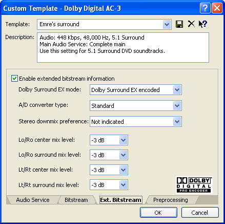

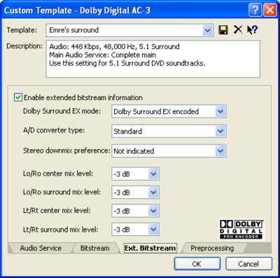

Did you see this?
You can see the EX support in Vegas from the attached screen shot.
Dolby Digital EX/DTS-ES Encoding?-2007-12-31_151748.png
