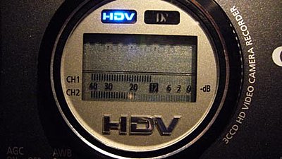

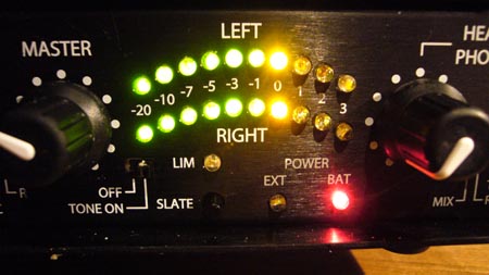

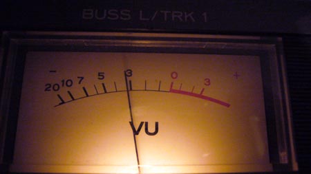

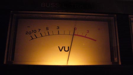

There is a huge difference sending a line out signal between ch1 and ch2. That is almost ~8dbfs.
I send a 1khz tone to the line out signal form the mixer (balanced xlr output left out and right out set to: LINE) and the Master setting is set on 0VU reading the LED VU meter for both channels on the ENG-44. I send this signal to a videocamera or an external audiomixer.
1) the LINE OUT on xlr gives a difference in amp between Left and Right, the right signal (ch2) is 8 dBFS softer then the left signal Ch1).
So, sending out a balanced LEFT/RIGHT signal at 0 db/VU, the Left signal is -12 dBFS and the Right signal is -20 dBFS
I checked an double checked this reading on the PPM meter in the videocamera, and also sending the signal to an external audiomixer. Both readings are the same. IF I go out balanced xlr output left out and right out switch set to: MIC there is no difference in signal amp in the left or right signal.

I changed cables, I used an external VU and PP meters, external tone generator, studio microphones, no luck. I'm not making mistakes.

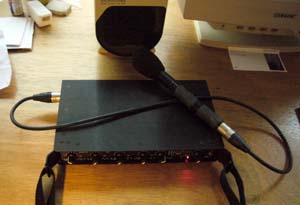

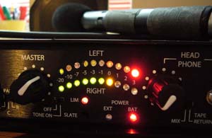

Test situation:
1 microphone AKG c480B connected to CH1 mixer, (send to Left). In front of speaker that sounds a 1kHz tone.
Master section normal, if you open CH1 you see LED lights LEFT all burning and it continues on RIGHT(!) before the red LIM Led starts glowing. Distortion is very noticeable.
If you send mic to Center, both LEFT and RIGHT LEDs glow and almost above the 3+ the LIM light kicks in.
Raymond Toussaint is offline   Reply With Quote

Old April 23rd, 2008, 06:30 PM   #15
Posts: 173
Roger, it is.
1. mixer was uneven in amplitude, so it is repaired and returned.
2. after repair there was no way to let the limiter/compressor work, so it is sended in again for refund.
The limiter just did not kick in, only after heavy overloading the limiter starts working. (See image). It only works proper with a stereo CH outsignal, so working with one mic to one CH out is not possible WITH any form of limiting.
That -last- problem was not part of the 1st return, then it functioned. Look.. if a mixer is not limiting, (I know you can internally set the limiting point) and it is not working, then I can't use it.
"Please note that having a limiter/compressor placed after the input preamp(s) is a standard bit of analog mixer architecture... as is having overload detection being commoned to both stereo outputs."
Sure, I also love a limiter that works before and after the preamps in the line out, but you can' t do that for the money I think?
If I need to set a mic to line level (?) or always send it out on center then I don't want the product. Sorry.
