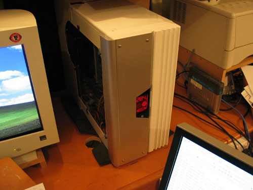

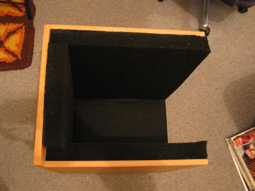

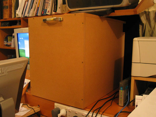

Weeill...I made the enclosure out of 18mm Customwood, and lined it as shown on the inside with 50 sound absorbing polyester duct liner called 'Novahush.
Yeh, it cut down the fan noise a bit but not sufficiently I thought so then I looked at replacing the case fans as well - which I have done.
The case had a 120mm and an 80mm fan blowing IN, and 1x 120mm fan blowing OUT. The 80mm job was the noisiest, so I replaced that and the other IN fan with 120mm 800rev Scythe fans http://www.ascent.co.nz/productspeci...?ItemID=364882 , and the OUT fan with a 120mm 1200rev Scythe fan http://www.ascent.co.nz/productspeci...?ItemID=363843 . Dropped the noise considerably, and with the box, majorly.
Put filters on the IN fans as well to stop dust entry.
Had to duct the exhaust out to one side (the opposite side from where I sit so as to increase distance for any noise - inverse sq law) and stop the warm air going back into the enclosure. Then had to drill a couple of big holes in my desk - one each side of the computer - to feed sufficient air into the rest of the enclosure.
The enclosure pushes up against a sheet of Novahush against the wall, and I've put the computer on some sponge as well to stop sound transference through the desk.
The temperature of the computer rises when the enclosure is on but only by about 3-6 degrees as shown by 'Speedfan'. Case temperature thermometer only shows about 3-4 degree increase.
So there you go...:-) Happy now.
