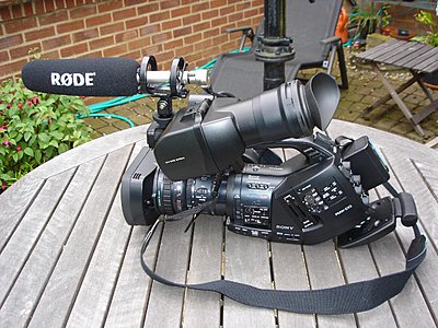

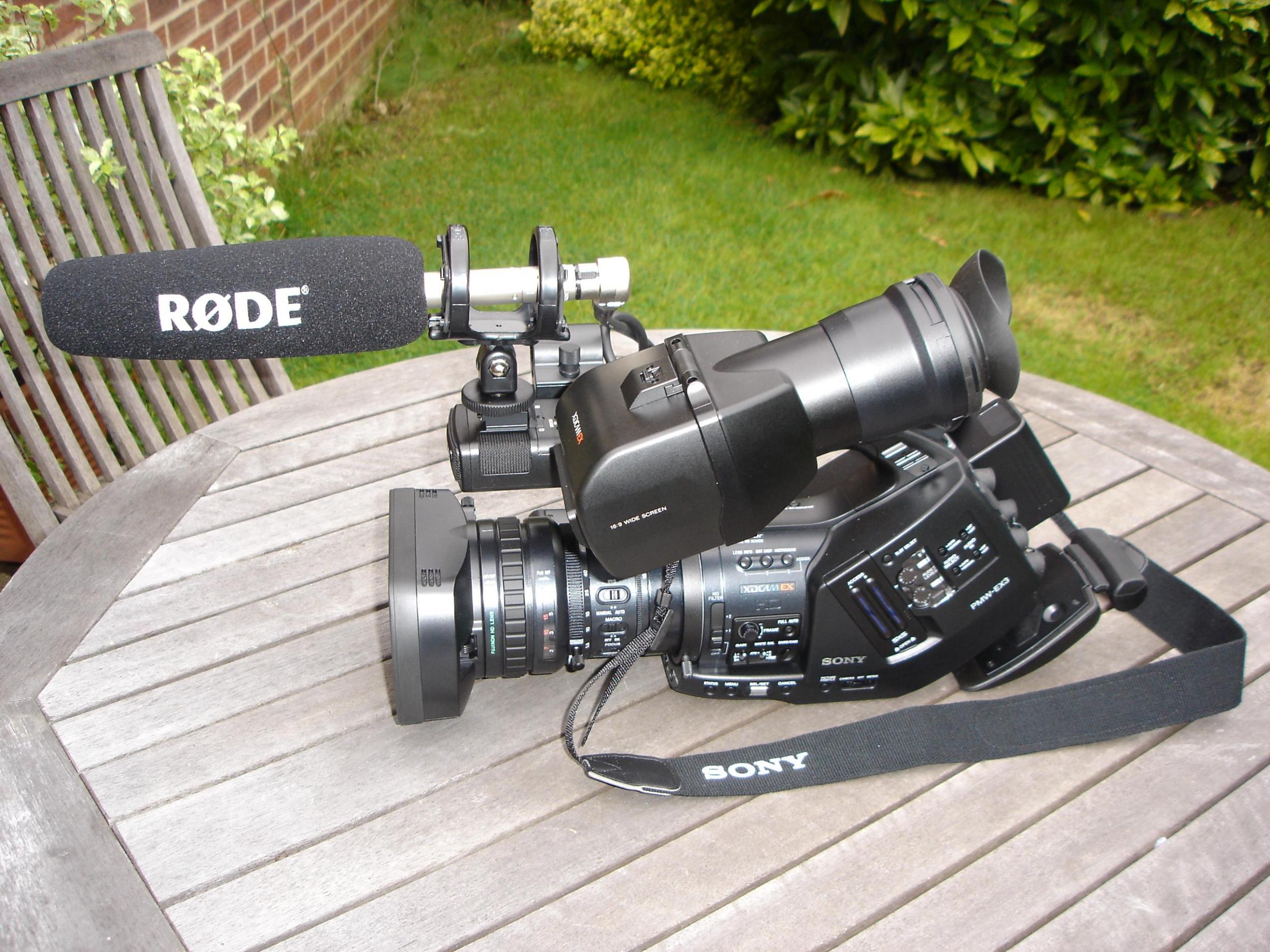

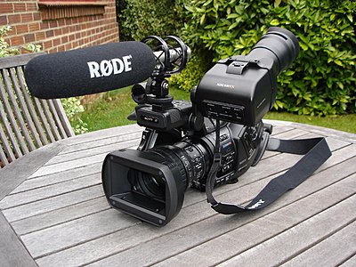

Just a few quick pics to show what the beauties look like together. The mic is sagging a bit in the suspension mount simply because I did not straighten it.

It looks nice but where do you put lights?

Very sexy 90 degree connector.

Did you criss cross the Bands of the Mount? Looking at the images it does not look like you did. Criss-crossing the horizontal bands when inserting a shotgun mic should help.

Marty, no I did not! Maybe that was in the instructions I should have read with the Rode supsension mount!
So there you have it, I post pics to help people on here see how the two items look and I learn something new that helps me/others as silly as me in not reading them. Thanks Marty.
That Rycote shoe extender also looks highly useful.

Great stuff Andy, that's some viewfinder on the cam. The RODE SM3 and 4 shockmounts *just* hold the NTG-3, you have to position it carefully.
Doubling those bands there's too much stretching going on...like to get a big TWANG! right on the money shot. I've got these in a hot cart at BnH, don't know the the diameter for the mic yet.

Diameter of the mic is 19mm and the K-Tek should work with the mic but will not work well on the SM3 (if this is what you intend to use it with).
Criss-crossing isn't really doubling it and should work fine and it is certainly worth a try.

Thanks Marty. My SM3 mount did come with its four 0 rings criss crossed. The NTG-3 tilts down a tad when it's correctly fitted to it, so I'm currently putting 2 19mm 0 rings on the mic to sit inside against the SM3 rings to stop the G3 slipping forward.
I heard back from BnH confirming your assumption re that polymer K-Tek suspension. The NTG-3 will fit fine they say, I'm ordering some sets.

To the best of me knowledge the SM3 is not criss crossed by default.
Here is an illustration of proper criss crossing that I hope helps.
While the K-Tek will fit the NTG-3, it will NOT work with the SM3 since the 4 points are too large for the SM3 and they will fall off.
K-Tek has a new mount called the K-Mount which should work nice when used in conjunction with the Clamp Mount Adapter or the Shoe adapter. The image of the K-Mount does not do it justice as it is a real beauty IMO.
Can you post some pictures of this setup?

Rode SM3 Mount - O rings
Well I tried my Rode SM3 mount with criss-crossed O rings and it's way, way too tightly strung for my liking so have reverted to it as it was in my original pictures above. This gives a much more gentle, softer/loose suspension that, in my opinion, despite the slight front end sag (easily correctable with angle adjustment on the SM3) will give much better isolation of the mic from the camera. Of course, as we all know, on camera is about the worst place for a mic anyway but sometimes there is no choice. If you really wanted to criss-cross it would need larger O rings I think/or the alternative above.
