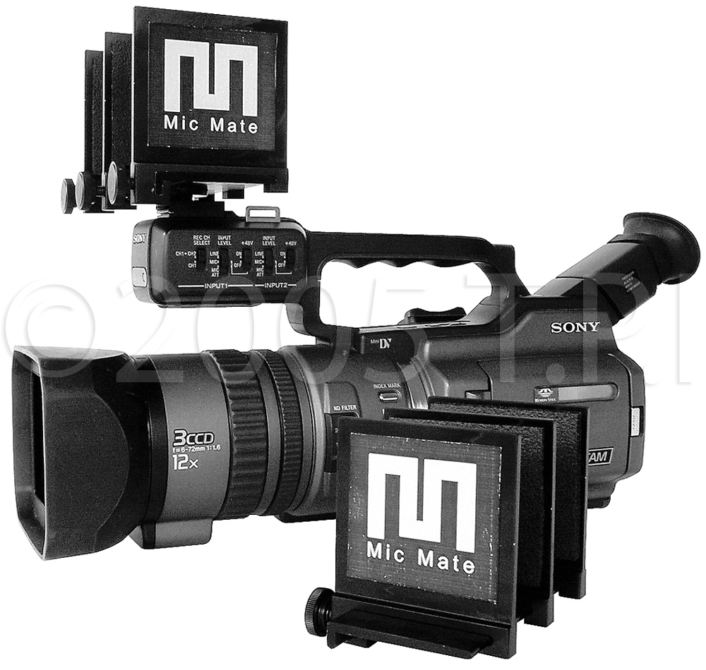

One tip on the camera side, there is a cool little shoe attachment you can get that will hold three wireless receivers. I have one of these and use it when we have a couple of wireless on the camera. It also allows you to keep the receivers straight up, or straight down, which will help extend the range rather than having the antennas horizontal. (Parallel to the ground)
You can search for it at Markertek.com it's called the Mic Mate. For some reason the link won't show up in the post correctly.
The mic mate works well with the Sennheiser Evolution G2 and the new Sony UWP series The Sony UWP-V6 Wireless System with Lavalier and Plug on Transmitter at DVcreators.net
Actually the new Sony's are kinda cool. The antenna tilts so you can point them any direction you want. Something tells me the Evolution G3 might do the same :)
