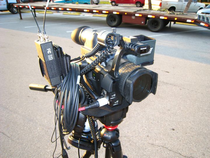

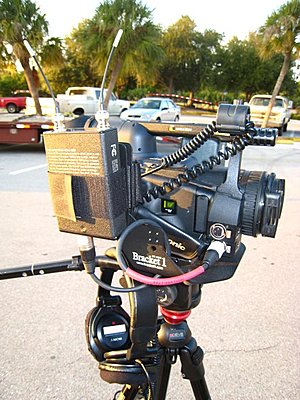

Some pics
Hi:
I dug these up from my Prison Break shoots in Florida last year. Both show the Bracket 1 setup I use with the Lectro. It is quite a hefty little package. The long XLR in the one picture has a wired lav at the end of it. Like a good sound person, I never use wireless for sit down interviews, that is lazy and stupid. Since we alternate between on-set BTS, then nail the crew and actors for interviews periodically, I have to be ready for both.
Also note Hoodman (a must for the Florida sun) and Cokin circular polarizer on lens.
Dan

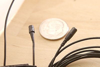

The Countryman B6 probably takes the smallest lav award. However, the new Sennheiser MKE 1 is pretty dang tiny too!
Below you'll find a pic of the B6 on the left and pre-production model of the ME-1. I wasn't allowed to show this pic until now....I've been sitting on this for months lol.
Pocket Recorder for Wired Lav-pi5j5986-version-2.jpg   Pocket Recorder for Wired Lav-pi5j5990-version-2.jpg
