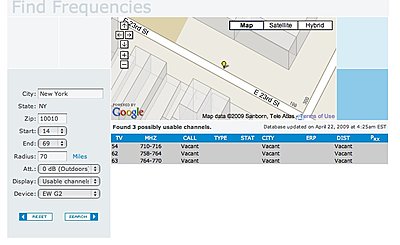

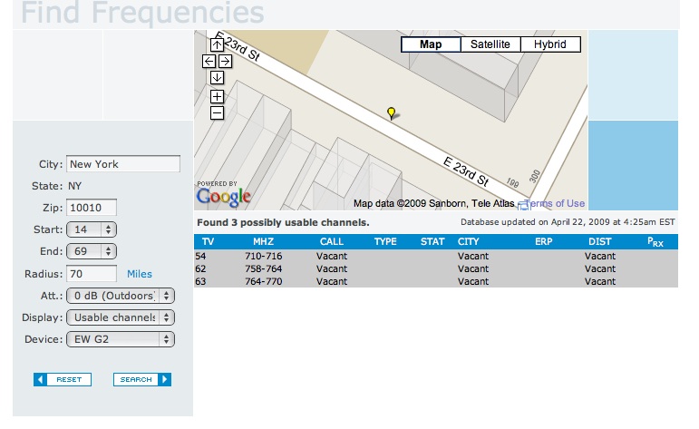

South FLA tough?
Try NYC!
The ONLY large block of clear frequencies is in the Class C range. That's why I bought that range. In fact if you set Sennheiser's Freq Finder to 70 miles (the TV Clear range I believe) NOTHING other than Class C freq show up!
Old April 22nd, 2009, 12:19 PM   #40
Join Date: Feb 2004
Location: Brooklyn, NY, USA
Posts: 3,841
EW G2 Usable Channels NYC Radius

I just spoke to Sennheiser tech regarding this issue. Those of us in major metro areas are really in a quandary about this.
The new G3 series will have significantly expanded frequency bandwidth. They'll have that info at the beginning of May. It may take them beyond that to update their Freq Finder but they'll have info by phone. The Freq availability change (as you probably already know starts in June). Apparently there's still some fuzzy areas about the time frame of implementation but the tech said there'd likely be a grace period through the end of the year.
He basically confirmed there's virtually nothing available in block A or B for NYC currently. I asked because I thought maybe I was misunderstanding the Freq Finder. Currently the scant few vacant areas are not in the G2 freq range.
