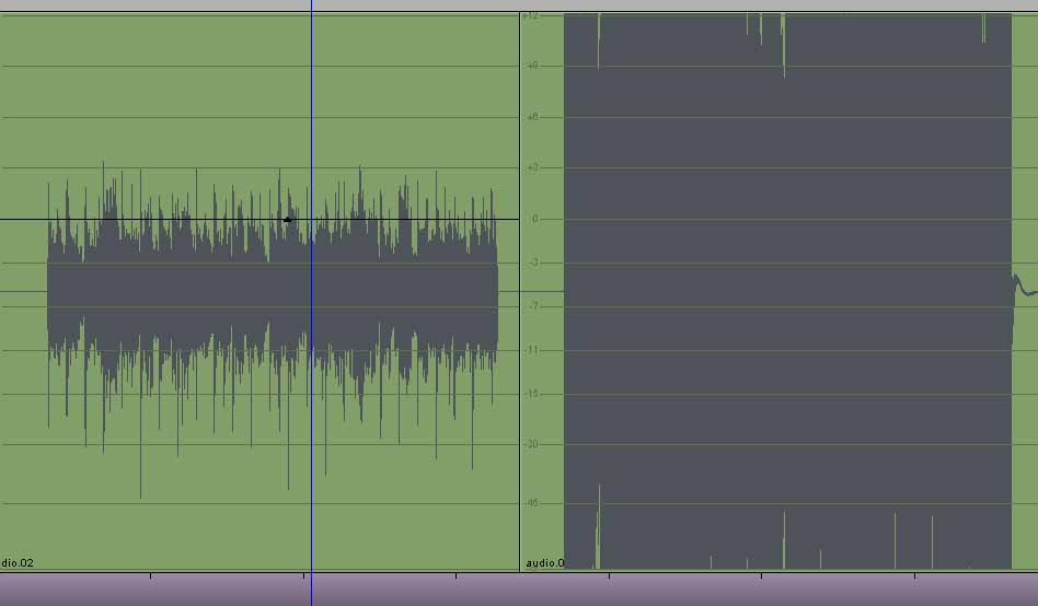

Okay, in another thread another poster suggested:
"Vito, you can tell pretty easily by looking at the waveform on your timeline. If it is clipped ---filled with wave from top to bottom --- you're overloaded. If turning down the trim on the camera gives the same waveform, just at a lower level but still filled top to bottom, your trimmers are post-preamp."
So I stuck my mic in front of my speaker at home and cranked a song into it. Attached is a sound sample and the waveform. Since the the waveform is not flat at -18db trim, does this mean my trim is pre-preamp?
From listening, however, the trim doesn't seem to be helping, so I'm guessing the mic is overloading.
