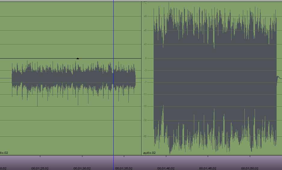

The sample on the right is clearly a maxed-out preamp. That's my message you quoted, and when I've overloaded my XHa1, the sample on the left has looked like the sample on the right, just with a lower amplitude. You have a very heavy waveform but with some amp headroom, as there is clearly preamp response in the spikes. My guess is you're right, the Rode mike is overloading. One of my collegues has an NTG2 with which he has experienced mike overload at a sporting event with thousands of loud-cheering fans, so it may be that this particular mike is sensitive to overload. In that case the in-line attenuator mentioned earlier wouldn't help (although it's a great thing to have in your kit -- we issue the Audio-Technica 10/20/30 db model, about $35, markertek sells). I use the Sennheiser ME66 and with some good luck have only maxed out the mike once, and that was in an extremely loud venue....might be worth an a/b trial if you can borrow one to compare with, might define the problem....best wishes/ Battle Vaughan/miamiherald.com video team

I think my image sample was misleading, as that's the default waveform height I see in Avid. If I reduce the waveform view, I get this sample (attached), which clearly is not clipped. It's the same recording and waveform, just the view is reduced. But if you listen to the audio, I'm sure you hear the distortion in the bass. And the distortion is still present at -18db trim.
So from your test suggestion, I think my trim is post preamp since I'm getting the same result, and it's the mic that's overloading, and not the preamp.
Looks like I need a mic for loud events...
Thanks again for your time. You guys are the best.

Yes, the first waveform would clearly have been a maxed-out preamp -- in digital audio, 0dbFS is where you run out of digits and everything just bangs up against the brick wall. Clearly you have some headroom, even with a very heavy track (which may reflect the source if it's one of those heavy-metal constant-noise things that doesn't have a distribution of loud and soft sounds). So, again, I think you are correct and your mike is maxed out. Usually the preamps load up before the mike as most have an upper limit somewhere around 130dB, but not the case here. I don't know the venue you are working, but perhaps a shotgun isn't the answer in that case, maybe a wider cardioid with a 10 or 20 db pad would help here. Or even a dynamic mike, like a Shure Sm87, which has a lower output than a condenser mike by far...that's a standard instrument mike that every band owns, and they cost about $100 new....good luck! / Battle V.

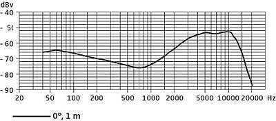

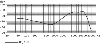

R...proper kick drum mics are very strange sounding... They have a good low frequency response, but not much up the top...
Surprisingly, a good kick drum mic has a strong high frequency response, as well as a low response, with little in between. The high frequency response is to capture that snap of the beater when it hits the head.
The SM57 is just the opposite: lots of mid response with little in the lows, and a nasty, falling curve after a 6 kHz peak.
My son and I have mic'd things with both mics side by and mixed to taste. The results are excellent on electric guitar. The BD mic gives a scooped, metal sound, but it's too extreme. Mix in the 57 and you can get exactly the balance you want. As you decrease the BD mic, you get more of a '70s or '80s midrange guitar sound. The BD mic really helps with extreme drop tunings and 7-string electrics.
Here's the frequency response of the Sennheiser e902:
Need good ears to tell me if my mic is "broken"-e902_frequencyresponse-1-.jpg
