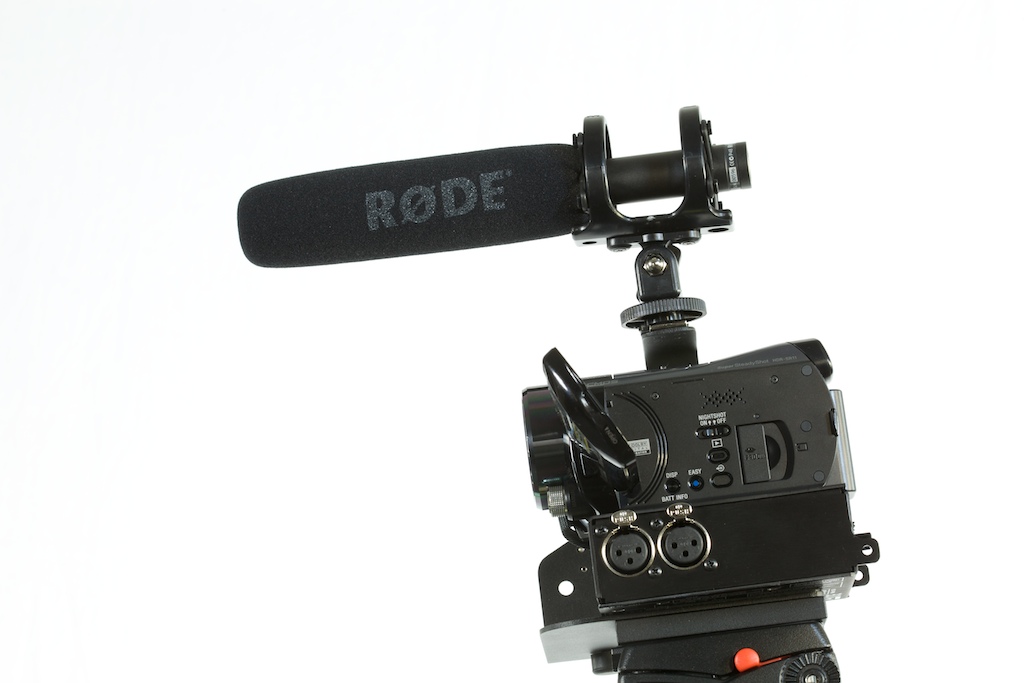

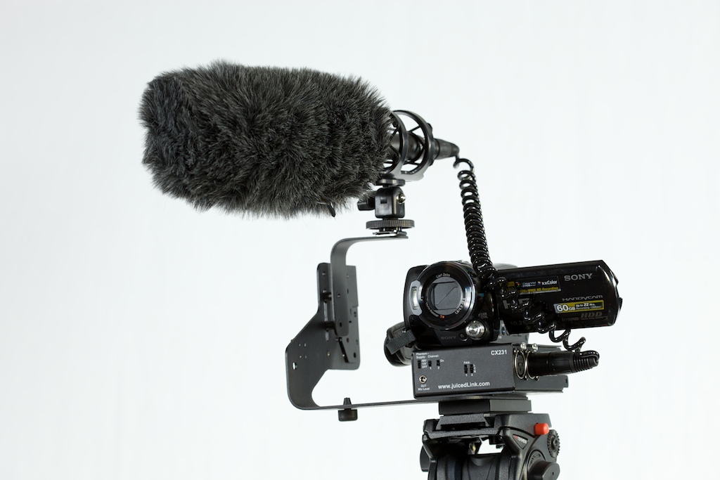

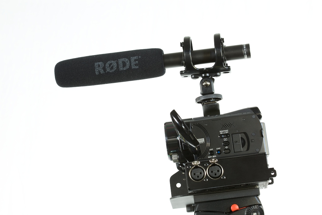

First off what kind of stuff are you shooting? Is it essential to have the mic on the camera?
If it were me, I'd go to the Juicedlink with Phantom Power and go with theRode NTG-1 along with a Bracket 1 Mini.
Why? The NTG-1 is shorter, and for a small camera like the HG20, you'll find the rig to be more balanced.
I'll go into the studio and build this for you along with WS7 and take a pic...back in a bit.
Guy Cochran

Here's the RODE NTG-1 and NTG-2 along with WS7.
Help - NTG-2 On-Camera Kit Versus VideoMic-ntg1.jpg   Help - NTG-2 On-Camera Kit Versus VideoMic-ntg2.jpg
Guy Cochran

Guy, thanks for both of your posts and the time you took to take those pictures. That helps a lot. While I'd like to have the setup you show in your third picture (with the wind muff), the cost differential compared to the NTG-2 kit I linked to above is going to be at least $450. While I'd like to spring for the setup you show, my wife isn't on board with the cost - so that option is off the table for now.
As for the stuff I'm shooting, it's just your average hand-held moments inside the house and outside. Nothing that really is conducive to setting up a mic on a boomstand.
