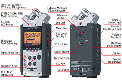

forgive me
Martin,
I reviewed your comparison and I need to say that your harmonic distortion test is flawed. (not that you meant to)
The H4N does not have ANY line inputs at all. The XLR combo jack is either MIC level or Instrument (HI-Z level). I've searched the manual, and no where does it state the combo jack supports a line level signal.
I even searched on B&H, Sweewater, and ZZounds for evidence that the H4N support line level, however I did not find such.
I've even attached a pic which shows the entire unit, but does not list a Line Input.
I wanted to make sure I wasn't being a complete butthead, so I researched the Sony PCM-D50 & Edirol R-4, and for those specific models, they DO directly support line level signals. This of course skews the test.
As an H4N owner, I bought the H4N KNOWING it could not directly support a line level signal.
Just wanted to bring it to your attention.
Preamp noise comparison of field recorder (Zoom H4/H4n and Edirol R-4)-h4n_27-1-.jpg
