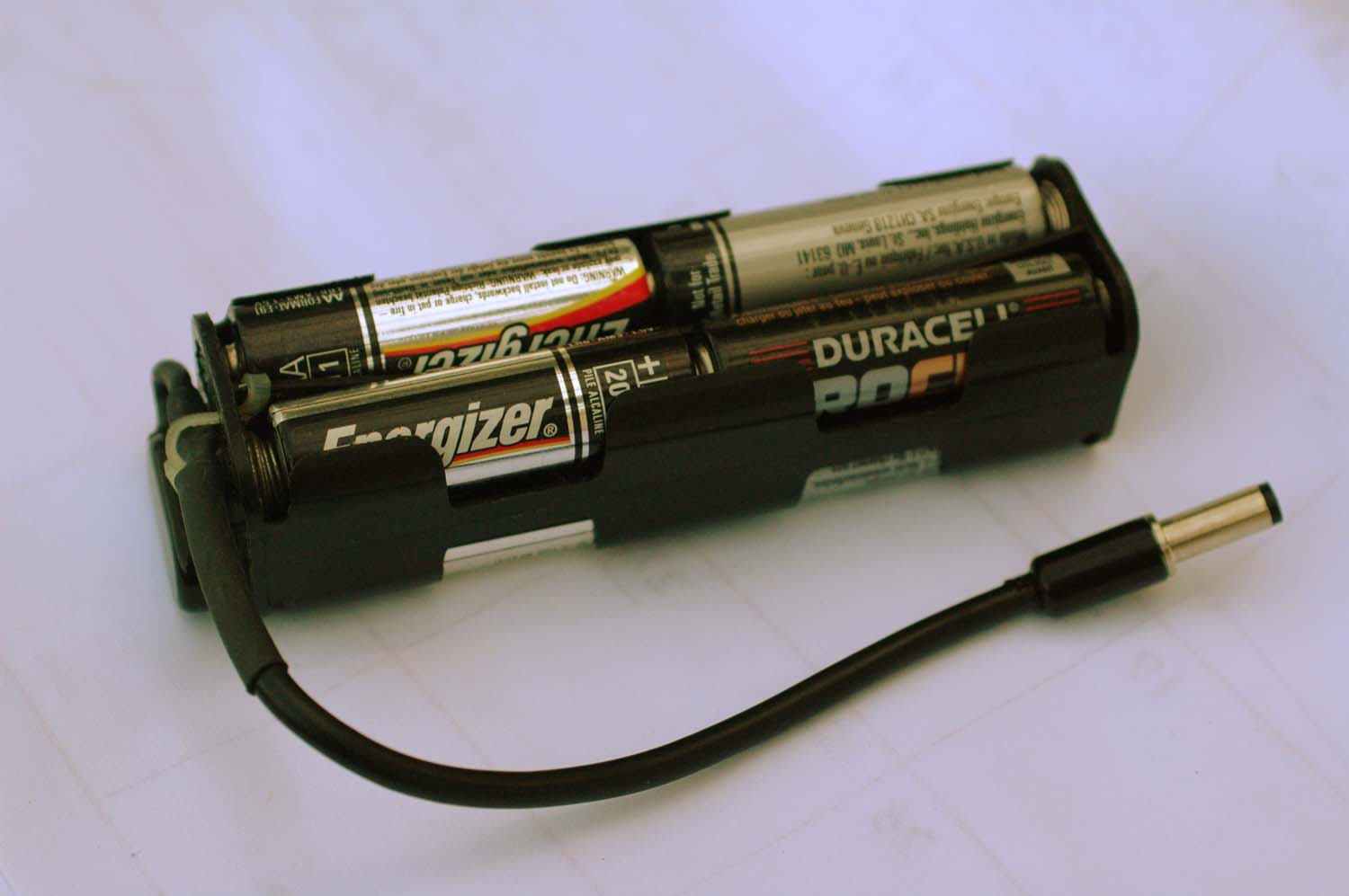

Depends, of course, on what your preamp needs for power. FWIW, I made several battery packs for field use for Rolls mixer/preamps, which take 12 volts at very small amperage, from 8-cell AA battery holders, some wire and cable ties, and the appropriate output connector, all bought at my local Radio Shack (tandy, I believe, in GB). Worked fine for recording pool feeds and other ad-hoc stuff such as that....of course, have to treat these gently, they're not rugged military-spec gear, but works in a pinch. You could get fancy with the basic battery holder and enclose it in a case of some sort, I suppose.../ Battle Vaughan

Battle, thanks, looks easy enough! So I will check Tandy for the right bits and bobs thanks.
