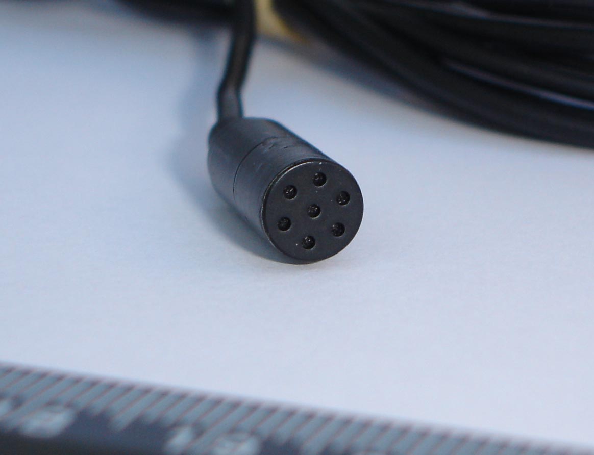

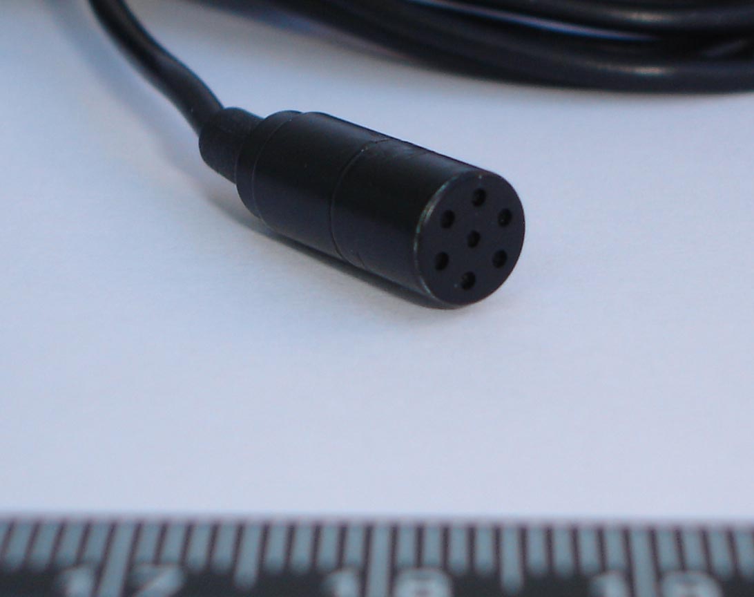

What is this Mic?
Also, maybe here would be a good place to ask about this mic. I got it about 6 months ago with a second hand G2 kit but have n't really had time to establish this mics particular properties (which I do with all my gear before using them on any paying jobs). Just taken a couple of snaps of it (attached) and I'd be pleased to hear what you experts think it might be?
It would be great if it was a MKE2 but I suspect I'm not that lucky!
Sennheiser ME2 or MKE2 Lapel mic-what-mic-1.jpg   Sennheiser ME2 or MKE2 Lapel mic-what-mic-2.jpg

It's definitely *not* an MKE 2 - much too large.
It's probably the ME 2-US.

Indeed, The ME-2 (US) I have is identical to the photo. (evil twin.)

OK, thanks to you both for identifying it so quickly. I'm assuming it's acoustic properties are going to be similar to the "normal" ME2 I have - i.e. adequate (rather than excellent) and an Omni.

The ME 2-US is a nicer mic. than the ME 2 (ball-shape) normally supplied with the -p systems.
It's a good value for money mic. but the MKE 2 and MKE 1 are vastly better.
