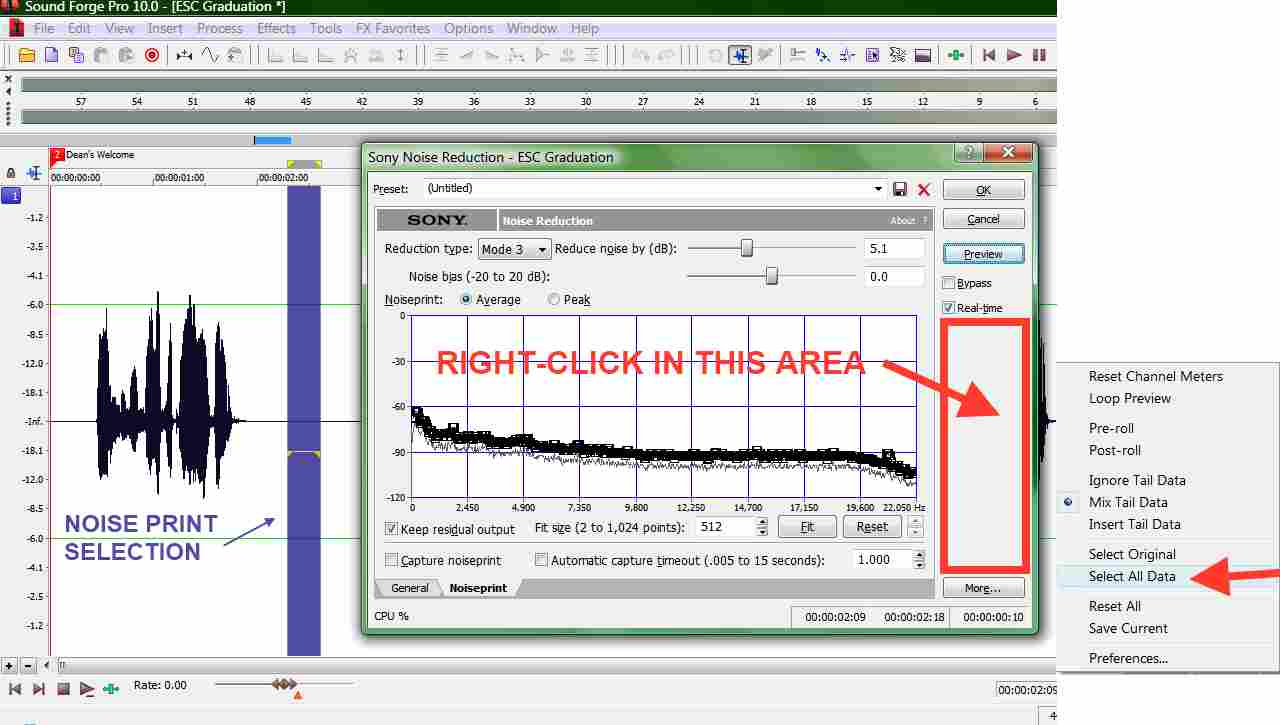

I have not used Izotrope's Rx, but frequently use Sony's NR-2 plug-in.
I find it better to sometimes use two processes instead of one. For instance, apply two processes of 8dB instead of one of 16dB to minimize artifacts, re-capturing a fresh 'noiseprint' on the second pass.
For NR-2:
Select a 'noise print' . (a few milliseconds of just the noise you wish to attenuate, for instance, room tone or when no ones talking.
- open NR-2.
- select the Noiseprint' button.
- check mark the 'Capture' box.
- select the 'Preview' button. (a noise print waveform graphic should appear after a few seconds)
- select the 'General ' button and adj, other parameters if desired.
- right-click in blank area under the 'Bybass' and 'Realtime' checkboxes in the General or Noiseprint' windows.
- from the pull-down menu: click "Select all data".
- click OK.
Last edited by Rick Reineke; August 30th, 2010 at 09:39 AM. Reason: insert graphic

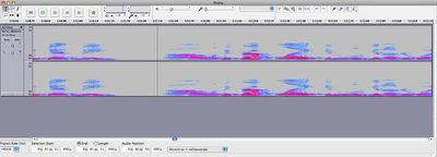

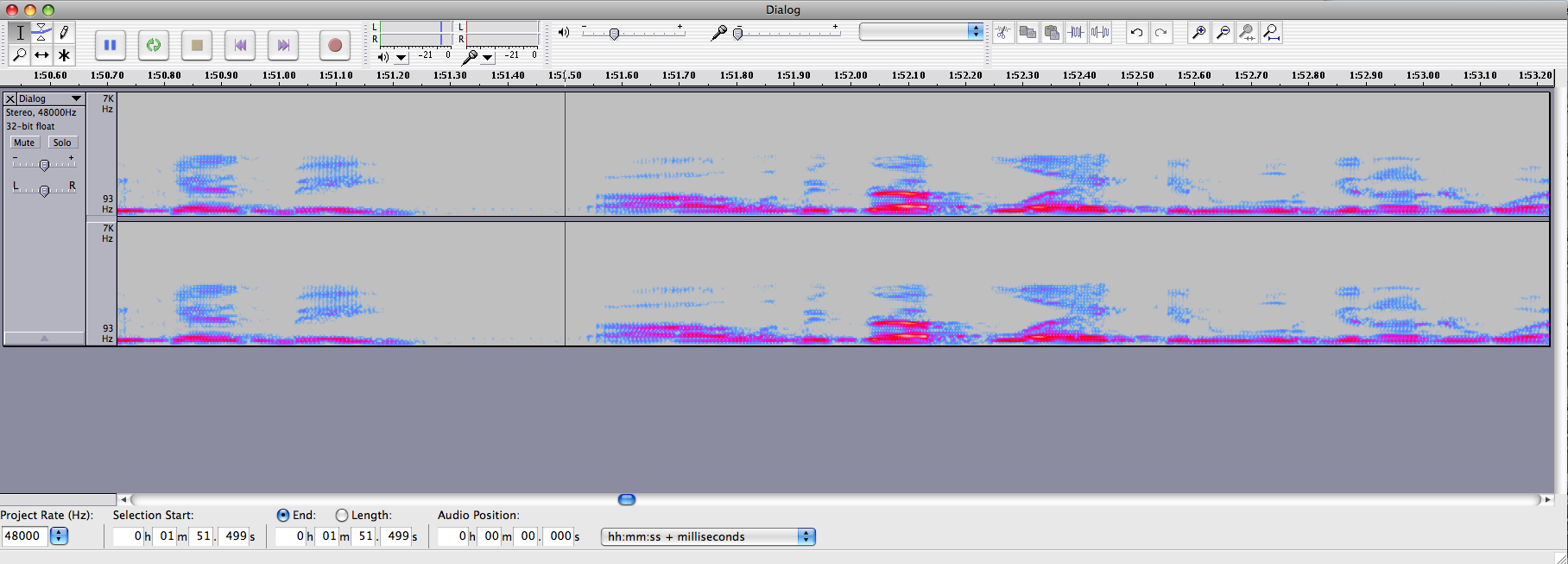

Old September 1st, 2010, 12:02 AM   #14
Posts: 1,675
Here is a screen shot of the spectrum in Audacity (IMHO, STP's is better looking, but this is functional). The sound portrayed is a baritone male delivering dialog:
This view is accessed in the track dropdown (here labelled "Dialog" - the name of the file I'm working on), set it to "Spectrum".
Your A/C should show up as a distinct line at a specific frequency. This will give you an idea of how pervasive the sound is before attacking it.
