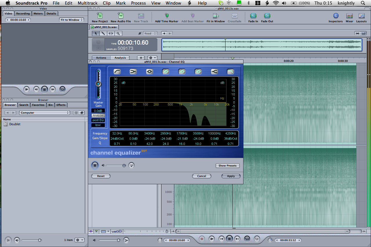

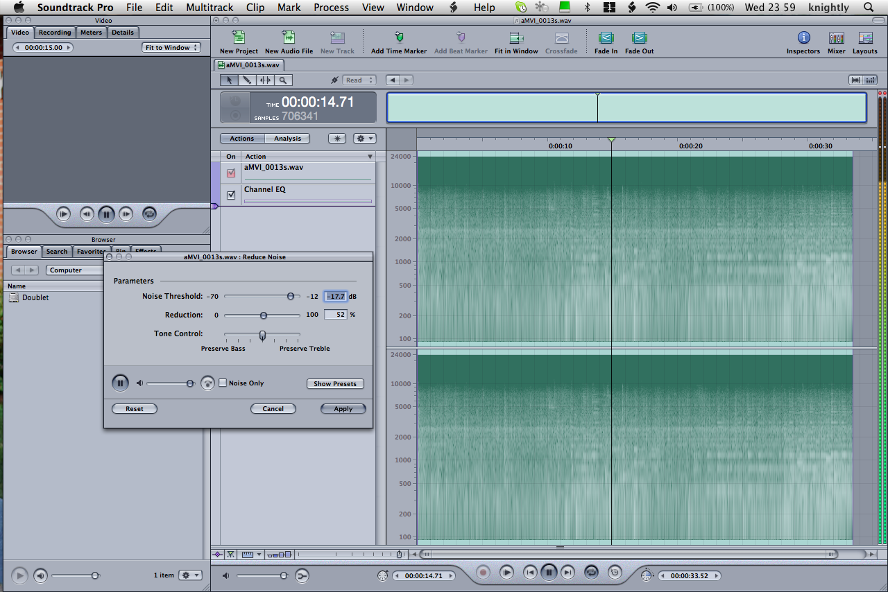

OK, the noise is relatively high frequency, and overlaps the guitar and ambiance fairly heavily... here's my results both with an EQ and a Noise Reduction filter in STP:
Way to remove stabilizer noise?-picture-1.png   Way to remove stabilizer noise?-picture-2.png
Web Youtube Facebook
