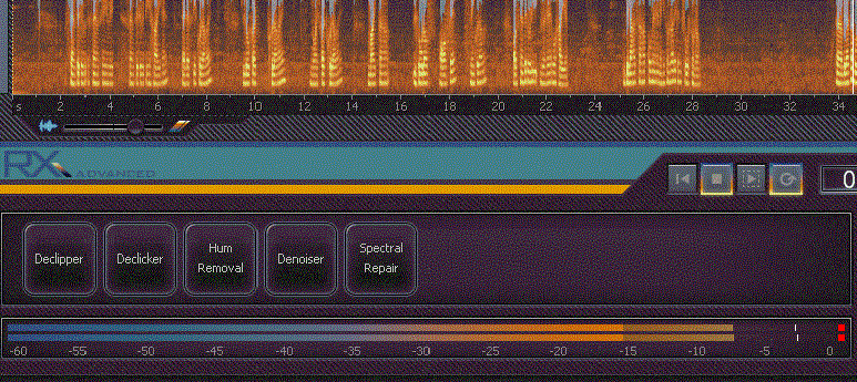

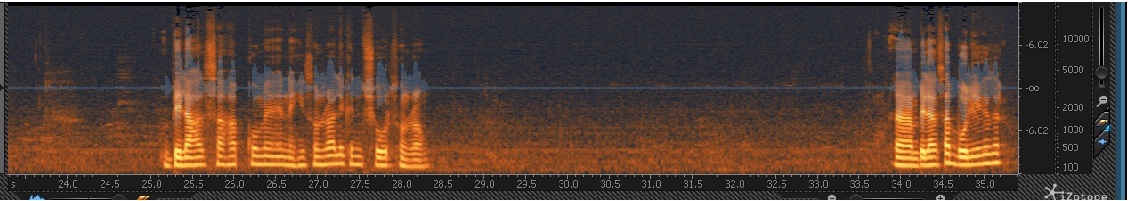

1. How can I clean my audio effectively?
My audio have 400 Hz hum and room noise. This is before the cleaning:
http://www.dvinfo.net/forum/attachme...1&d=1299927154

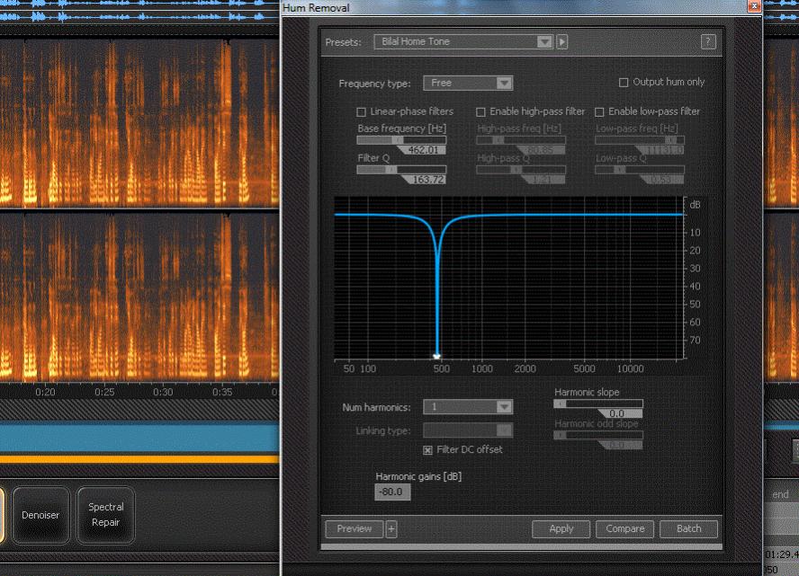

I removed the hum as:
Base freq= 462.01 Hz
Filter Q = 163.72
Num Harmonics = 1
Harmonic slope = 0
Harmonic gain = -80dB

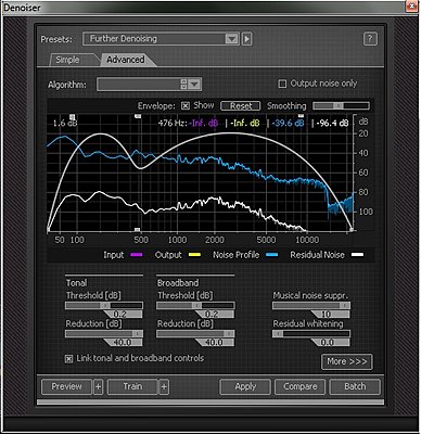

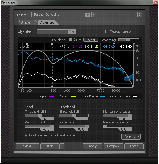

Then I cleaned the ambient noise as:
Tonal & Broadband Threshold = 0.2 dB
Tonal & Broadband Reduction = 40 dB
Musical Nosie Suppr. = 10
Residual Whitening = 0

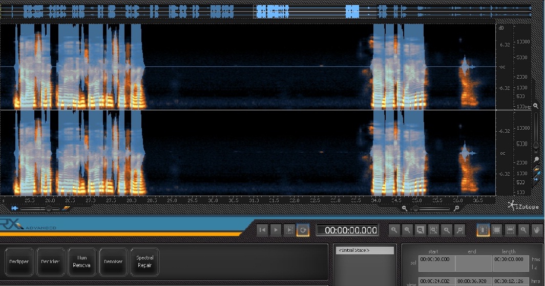

I used this preset two times, and got these results:

Screen shot of iZotope:
