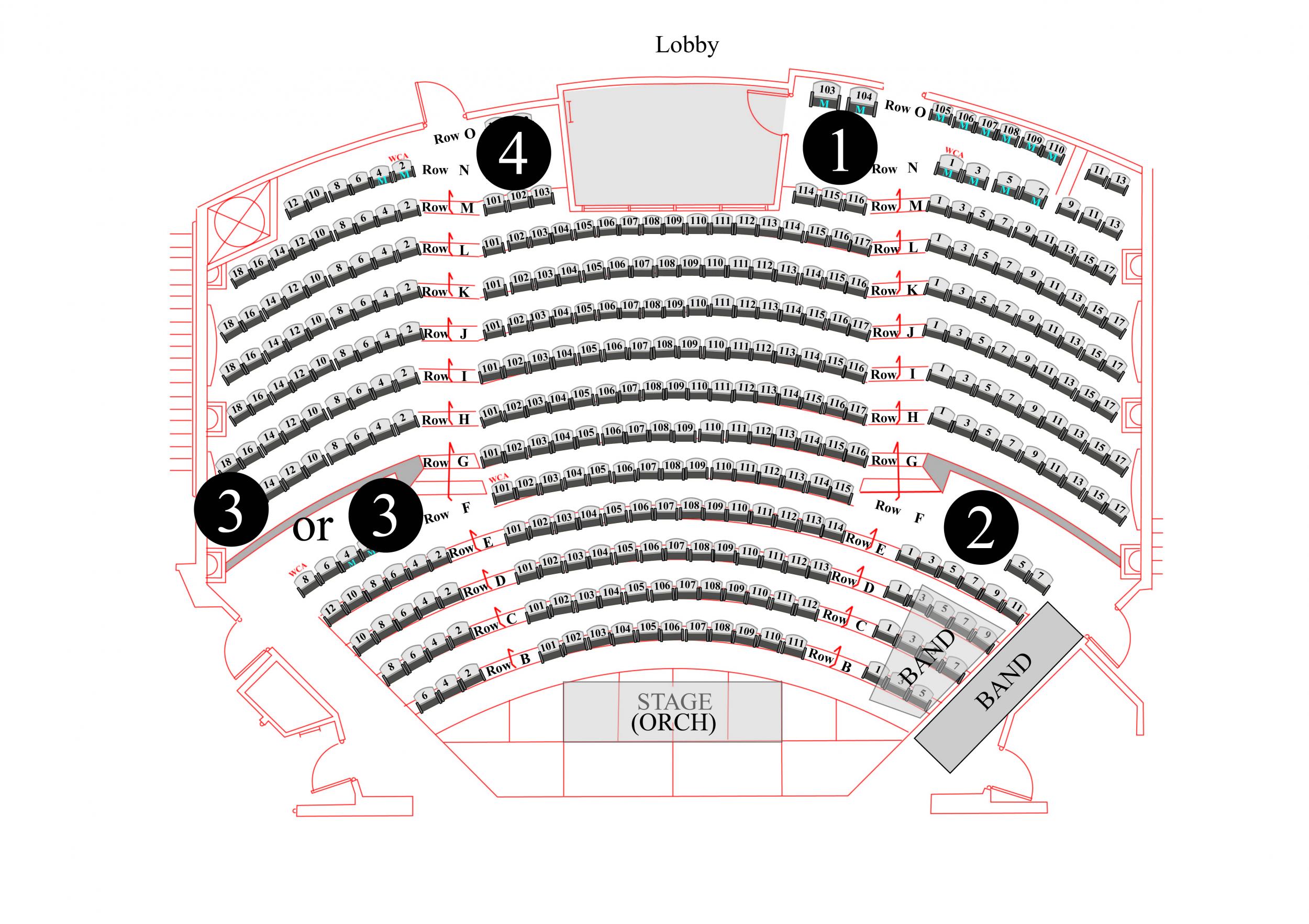

Kirk, thanks for the link. As I mentioned, I've spent several days (actually months) on the web reading up on this, including the forum you directed me to. That's where I got my observation about the diversity of opinion on all matters audio.
Greg, we usually have two cams behind the back row, about 50 feet from the stage, on either side of the booth, which is centered behind the back row. We also have two cams on the sides, on a platform behind the fifth row on the side seating areas. There's a small half wall behind each platform which hides our cams pretty well. The theatre was designed by some big-shot acoustical designer who I think did the main Symphony Concert Hall here in Seattle. The walls are covered with all these pyramid-shaped acoustic reflecting panels and it sounds great live. It's just when we try to make the sound stick to the videotape that we have issues.
Here's the floorplan. The proscenium itself is actually the very bottom of the picture with the main part of the stage not shown.

First of all, that's a nice (if rather wide) small auditorium. Only about 340 seats. The students should be able to fill that easily without any amplification. If they cannot project out into that size house, they should not have lead roles. In terms of reinforcement, there should be no need for body mics. Therefore, the only real reason for body mics would be for recording, so I'm starting to understand the teacher/director's objection. It's not a Broadway show in a 2,500 seat house.
The third row appears to be only about 10' from the lip, about 20' from the proscenium. If you hang your mics that close, and get them down as low as possible, I would think that you could easily pick up any stage action.
Out of curiosity, where is the pit area you talked about? The first row appears to be only about 3' from the stage. I don't see any place for an orchestra between the stage and the audience seats.
Actually, I don't think a "Broadway cast album" recording, with body mics, is realistic for high school students in this venue. That will capture something that nobody actually saw, it won't capture the students' actual performance. Given that you seem to have no concerns about expense and time, you should be able to get a good archival audio recording of the performance. If it then bothers you that the real audio doesn't match your XCU shots of the performers, perhaps the issue is that the camera shots are unrealistically close to match the audio in this situation.

Excellent questions all. As I mentioned, most of the students (especially in the Upper School) have no problem at all being heard in the back row when you're there live. It's a priority of the faculty to teach them to do so and does in fact explain their reluctance to add mics of any kind.
The arrangement of the auditorium varies by show. For the last show we did (the one I sent you the sample from) the four panels surrounding the word "STAGE" on the diagram -- front and center in that apron -- were removed and that was the pit. Often, the band/orchestra accompanying the musicals sits in the area that appears to be an aisle between cam 2 and the side wall, and may spill into those seats, which would be reserved for that purpose. (If that description isn't clear I can post another graphic).
The whole "perspective" issue is a "nice to have" but not a "need to have." All I've ever really been concerned about is getting the sounds of the performers, clearly and not like they're inside a tin can, to be heard over the instruments. And secondarily, to remove the room echo and boominess and of course minimize audience noise. I actually have no problem when our shots are in CU but you still get the whole-house sound, because the nature of the sound should not, in my mind, change with every cut and having a very close audio presence would sound weird in a wide shot. (Which is why I always UNcheck "Audio Follows Video" when doing the multi-cam edit. Which in retrospect doesn't matter because I never use the raw audio from the cams anyhow -- although they can be part of the mixdown.) As with images, I want the cleanest source material possible and I can always degrade it in post -- but as we've learned you really can't make it "better."
I do, in fact, have grave concerns about both cost and time, but I am willing to do what it takes without wasting either.
Really appreciate all the time, effort and thought you've put into this. It's way above and beyond. Not sure I would have the patience to stick with this for someone as cranky and opinionated as I am. Thanks again.
Edit: Here's a plan showing where an orchestra or band might be when doing Musicals. If the band extends into the seating area they might remove the seats or they might just build a platform extending the first band area over them. Obviously for full concerts they are all on the stage.
