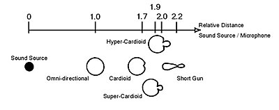

Are you wanting to record room sound or the sound of the performance? NO mic will give you good sound from the back of the room.....no matter how much you spend.
If your after a battery powered shotgun mic also have a look at the Rode NTG2.
This diagram might give you some comparisons.

You might have better luck with a cardoid or hypercardoid hung over the stage, as much toward the front of the stage as you can, angled back to the performers...or even two, if that's do-able. Anything from the rear of the hall, even in a small venue, is going to pick up audience noise and room echo to a huge extent, humbly suggest you won't like the result....:)

It's not that we're audiophile, or pros, it's because the sound at the back of the room is simply dreadful - and worse of all, you have all the kids going whoop, whoop almost continually, meaning that you may not even be able to hear the music.
In all honesty, the mic in the camera is probably going to be just as good as anything plugged in. What's the old saying, "you can't polish a t*rd?".
The advice to not use a shotgun inside isn't quite right - it's good advice for a small room, because of all the reflections, they usually sound very odd. A shotgun at the back might help narrow the acceptance angle - but there's a lot of rubbish in between the stage and you - noisy kids.
In reality, the very back is also the worst for picture too. If you zoom in to fill the frame, then you need a very good tripod to stop the image wobbling - and if you zoom out, you get people in the frame too! Obviously, it's often the only solution - but not much you can do on the quality front.
