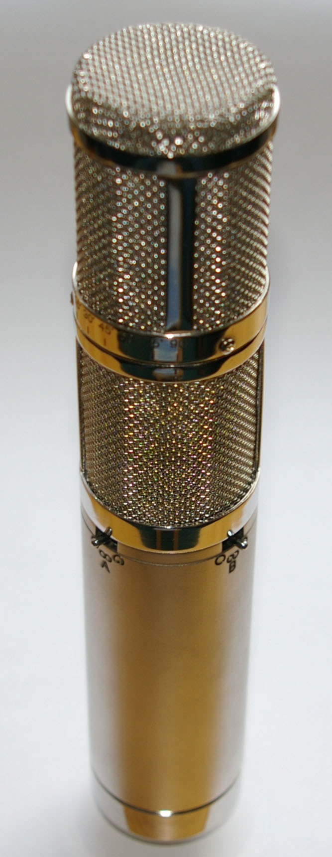

X/Y for audio work with music groups that have a proper musical balance and are not amplified. Although for orchestras, choirs and work in churches, I always use this single point stereo mic. Modelled along the lines of the old Neumann SM69, this Chinese mic does it for me. Two capsules, each one omni/cardioid/fig-8 on top of each other with the top capsule rotatable through 90 degrees. So you can place it, select a system that will work in the space, and then adjust the spread manually (or use M/S and do it later). Really handy - one mic, one stand, one cable back to the splitter/PSU.
That looks like a copy of a vintage AKG mic I think it was the C24, I had the mono version a C12 a few years ago but sold it for megabucks!
