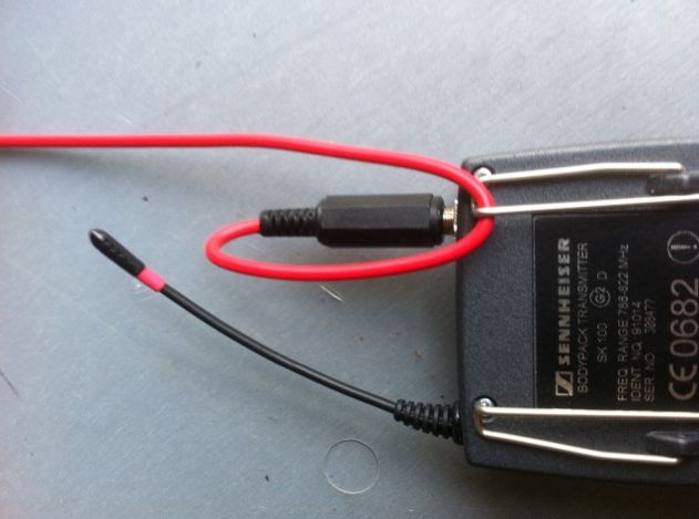

Senni locking plugs are often hard to find at times and when you do find them they aren't cheap... Standard 3.5mm stereo plugs can be used in an emergency (Im not advocating this as a permanent fix) just loop the cable through the TX clip to stop the connector being pulled out.
I have done a mock up with red cable so its easy to see.
The little bit of red heat shrink on the antenna is just to identify my units as TX / RX pairs, I have used red, blue, green, yellow, white.... makes life simple on location ;)
