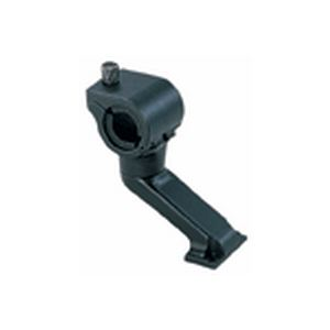

I was looking for a standard mic clamp like the one below.
Chris
