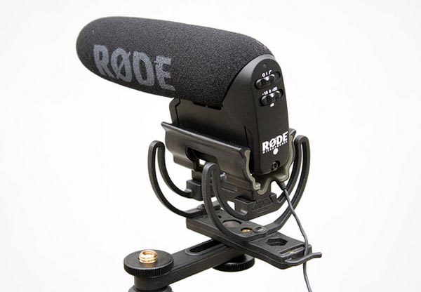

Several people have removed the horrible Rřde shockmount and then clipped the mic. into the Rycote Universal Camera Kit.
The patented Rycote "Lyre" mounts are the best shockmount around - at any price.

Great solution but at $179 I would be better off just selling the videomic pro and getting an NTG-1 to go along with my NTG-2!!!!!
