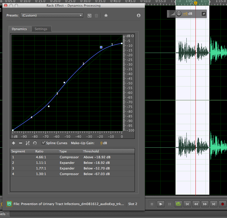

One more thing. I can't for the life of me get a grip on the "compressor" filter (either single band or multi band). Instead I've just been using the "hard limiter" withe the ceiling set to -6db, and a healthy input boost.
I just discovered the "Dynamics Processing" and I'm really into it as I can selectively boost audio in different db ranges. The only problem is that I'm getting a sort of high-end "rustling", that sounds similar to the sound that a snare drum can make when is rustles in the background. De-esser helps a little. I don't think this sound is in the original recording either, but rather an artifact of all my tweaking.
Any suggestions?

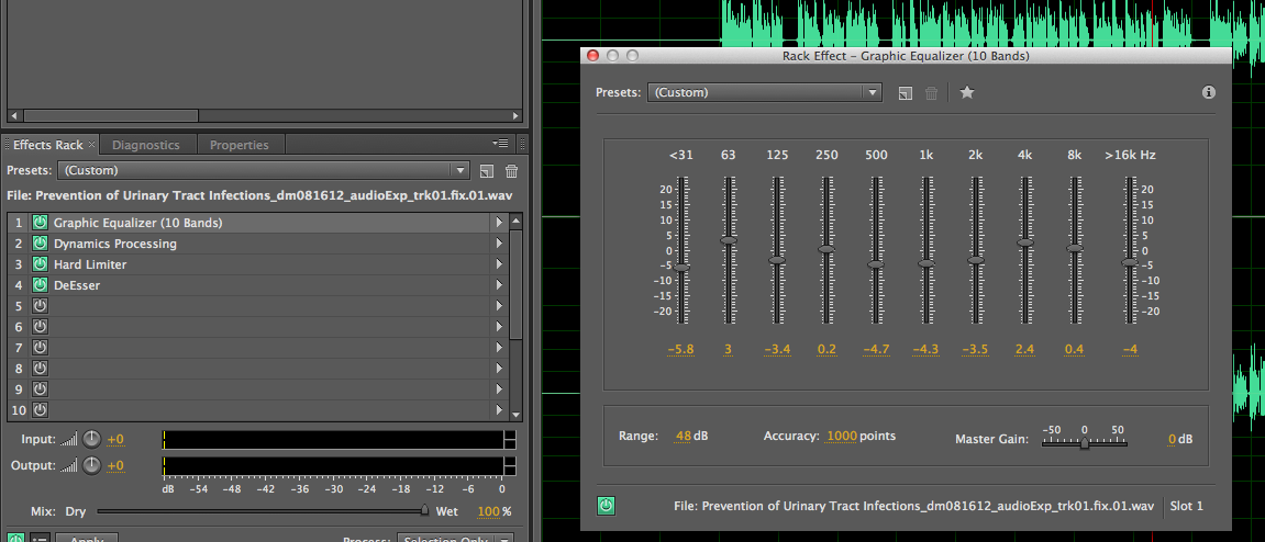

Anyways, here's an example of the "rustling," it's not the most extreme example, but it works. I also attached a screen shot of the "dynamic processing" that I used and that's all that's been done.
Let me know what you think and I'll defend my (good) intentions later.
-denez

for what it's worth, here's an example of the EQ'ing and other processing that I normally might do.
I did not do any noise reduction. Also, I'm not entirely happy with the results, but that is often the case. The voice sounds "fuller" to me, and dropping the mid range gets rid of either a "telephone-y" sound or a back of the throat "nnnngggg"-type sound.
I'm worried that I'm just butchering it and making bad audio worse...
Also, the hard limiter is giving an over all gain boost and clips at -6db. The de-esser is trying to get rid of some of that "rustle."
thanks again for all the help so far.
-denez

Thanks for posting these. The first 2 samples didn't sound too bad to me, I've heard a lot worse clothes rustle.
The sample above also doesn't sound too bad, don't forget viewers will adjust their playback volume to suit themselves.
This is not for transmission in a bunch of other over compressed soundtracks on TV, where yours might not sound loud enough in comparison. Is it?
Cheers.

Gotta be honest. It doesn't sound bad at all. The rustle that you describe kind of sounds less like clothing rustle than preamp or floor noise.
In any case it didn't sound bad on my computer but as Allan says, a lot will depend on the final tramsmission circuit.
Don

I agree with Don, for the stated purpose I think the raw file sounds fine.
I hear absolutely no difference between sample #1 and sample #2, except that sample #2 is about 4dB louder than #1.
The room tone is not objectionable IMHO. It sounds as if it was recorded in a "real" room somewhere, and not on a sound stage. What do we see in the background of the shot? If we see a real working hospital room, then audio with a completely clean background would seem very artificial.
I don't hear an objectionable amount of air handling noise, which I expected based on your description. There is a bit of equipment noise, and you could lower that with some judicious notch filtering, followed by a small amount of active NR. You don't give us any significant amount of room tone, so it's hard to analyze to find the frequencies in question.
IMHO sample #3 has less intelligibility than the other two; that's because you lowered the upper midrange frequencies (around 5kHz) significantly. If you want to increase intelligibility, follow Allan Black's suggestions above.
I am not bothered by any clothing rustles.
That was not an objectionable quality in the track itself. That is the objectionable quality that is characteristic of the Sony phones. TERRIBLE phones for mixing, they give you a very inaccurate idea of what the track sounds like. I don't quite understand why you can't mix on speakers... somewhere, some time.
Indeed, a small amount of dynamic compression might help the track, it depends on playback circumstances. If it will be played on bad speakers in a noisy environment, use a little compression. If it will be played in a relatively quiet environment, on halfway decent speakers, the compression would be less necessary.
