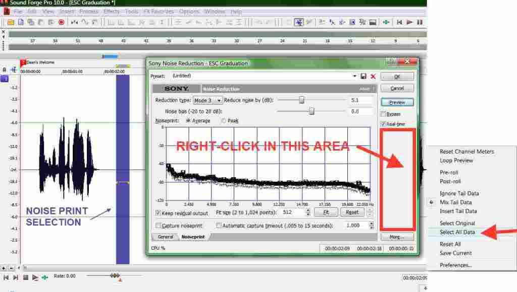

After selecting and capturing a 'noise print' in NR-2.0, you can right-click anywhere in the blank area just below the 'Bypass' and 'Real-Time' check boxes, which will bring up a context menu... There your may choose "Select All Data"

To clarify, here is a screenshot of the NR 2.0 window I posted on the SCS/Sound Forge forum a few years ago
