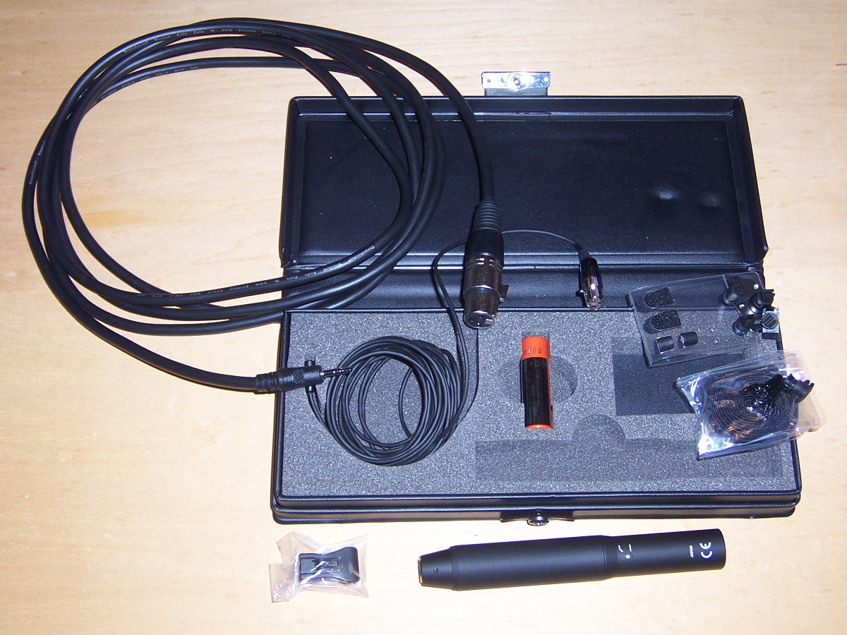

Old January 28th, 2013, 09:06 PM   #11
Join Date: Jan 2011
Location: Pennsylvania
Posts: 1,796
Re: AT831R Lav and H4N?
Rafael, I'm glad you were able to find the -R version in stock. Several stores' websites up here indicate that it's out of production.
I wonder whether anyone makes a generic Phantom to Plug-In-Power adapter, that would work with run-of-the mill PIP mics. Seems to me that would be a handy gadget to have in one's kit bag.
Old January 28th, 2013, 11:53 PM   #12
Join Date: Jun 2010
Location: Seattle WA
Posts: 1,261
While this is not exactly "on topic", I am very happy with this little AT899 lavalier omni mic I picked up today. It was used but apparently very gently. Two of the accessory bags hadn't even been opened and they threw in the 10-ft XLR to 3.5mm stereo mini all for $55.
Since I didn't have a lavalier in my kit this will fill a hole and make a nice addition to my mic (and cable) tool box. Did a quickie test and it worked very nice.
The mic is much smaller than I thought it would be and the wire .... is really small. And kinda springy. It's a bit of a challenge to coil up. It has a very nice clip accessory kit and really small foam covers.
The power module is an AT8537. The mic is apparently an older model and I had some difficulty finding information about it before I opted to buy it.
Hopefully this makes the "a wired lavalier is better than a wireless one" people happy.

Old January 29th, 2013, 08:46 AM   #13
Location: New York
Posts: 2,044
I have had a AT899 for 10 or more years now, while it sounds good , I don't much like the stiff cable or the OEM mounting design, so I don't use it much. I understand AT changed to more pliable cable stock, so John may have an earlier. model. Either way, $55 is a great deal, especially with the power module.
Old January 29th, 2013, 11:33 AM   #14
Join Date: Jun 2010
Posts: 1,261
Rick - you're correct, it is older. The gal I bought it from had retired from doing video work and was selling off her gear. She said they were downsizing and she had no use for it anymore.
The Power Module battery compartment was nice and clean with no battery residue. There is one little thing I noticed, though, and that is the switch for the bass rolloff seems to be a little depressed because it doesn't stick up above the surface of the cylinder. Don't know if this is the way it's supposed to be or not. No big deal but it does make it a little more difficult to move.
Power Module: Even though the system got between a 4.5 and a 5 start rating, one of the negatives people mentioned was the Power Module and the difficulty of dealing with it but there weren't many suggestions about how to handle it. Any suggestions?
Mic: All I can say is, this mic is really small. Really, really small. A guy could become a secret agent with this. Good open mic gear?
This is my first AT mic. The others are a ME66, ME64, and the Rode Stereo Video Mic. Besides a wireless lavalier I'm also looking for one, and probably two, vocal mics.
Old January 29th, 2013, 01:23 PM   #15
Join Date: Jul 2003
Location: Burlington
Posts: 1,976
The switch is supposed to be completely beneath the surface so it can't be moved unless you really want to change it, with a very small tool.
