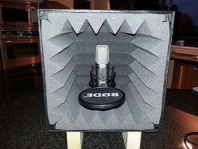

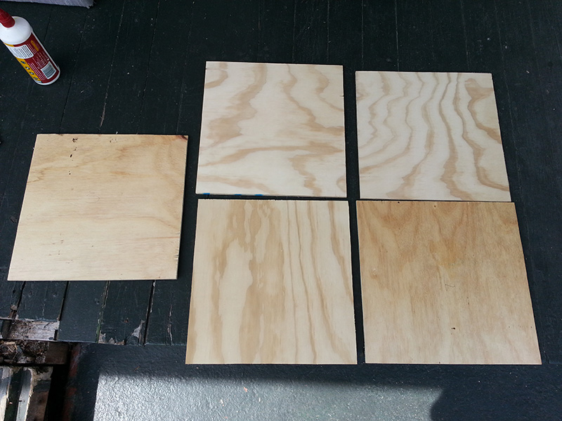

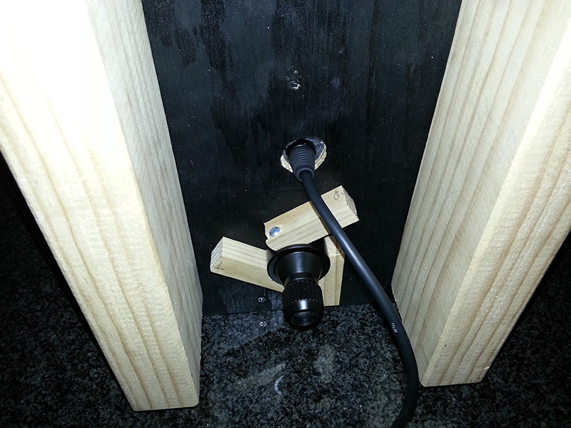

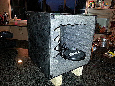

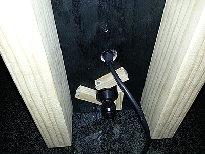

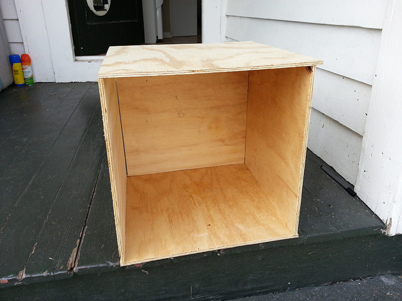

Well, here's what I did...
I got myself a great deal on a Rode NT2A and some acoustic foam. I then built myself this box.
The mic screws into a cheap microphone desk stand which is mounted underneath the box (as pictured). I have all of the measurements and specs if anyone is interested.
Oh, and it sounds fantastic! My only issue is that it's a little bit bass-heavy, but that can easily be fixed in post.

Cool Jody looking good :) a version of our Harlan Hogan rig and the NT2-A is a good choice, make sure it's set on cardioid pattern.
Run some tests in post before you decide it's a bit bass heavy. If so, try the 40Hz bass cut at -5 or -10 .. that's how we test ours on spoken voice.
And try setting your rig up on a big slice of carpet.
Cheers.

Thanks for the tips. I would have loved to buy one of the porta-booths but unfortunately when I took international shipping costs into account it was more economical to build something. And there's nothing quite as satisfying as sawing and nailing bits of wood into something useful ;)
Jody Arnott is offline   Reply With Quote

^ yep :) Take your time with the voice testing .. save good sounding voice tracks for reference later when you're in a hurry or not feeling the greatest.
Note the mic settings. Have fun.
Cheers.

I've been using the NT2A with the custom-built recording booth (pictures above) for a couple of months now, and I'm pretty happy with how it sounds.
My voice sounds very natural, my only complaint is it's a bit heavy on the low frequencies, but that can be fixed in post.

If you must build a box, I strongly recommend using Homasote (or Celotex as a poor imitation) rather than plywood. Plywood will be resonant (unless it is very thick and the sides are very small) and may add some undesired coloration to the sound.
Homasote is a great non-resonant product. The only catch is that you might need to reinforce the junctions where two pieces meet, using a small wooden 1"x1" or similar. Screws through Homasote usually hold just fine (and you can reinforce the heads with fender washers), but screws into Homasote are likely to pull out.
I suppose in theory it would be best if the box had no parallel sides; but then you're bringing geometry and angle cuts into the picture. It probably doesn't matter that much, although Harry Olson swore that speaker enclosures sounded much better if they were non-rectilinear.
