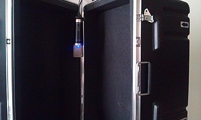

Re: Tips for voice over recording
This might sound crazy (and it probably is) BUT I get great results with an M-Audio USB mic using my steadicam case as a mini sound booth. I don't use the software that came with the mic. I use Audacity instead.
I've had people shake their head and laugh at me when they see the setup but are completely amazed when they hear the result.

Chris: I actually bought one of those, for a friend who said she wanted to try her hand at recording audiobooks. (Libravox volunteer program.) It sounds surprisingly good for $50 total, especially given the fact that she can use it with her vintage laptop, without worrying about the laptop's audio input electronics.
And by the way, that steadicam case is a good idea! In fact you could make up a triangular piece of masonite or 1/4" plywood, with some foam glued on it, and store that inside the case until you were ready to record, at which time you'ld rest it on top of the open case to make a padded top of the "booth."

Check out the attached photo above to see what it looks like assembled. I can control the "presence" of the mic with how much I open or close the case around it. If I close it down too much it starts to sound artificially boomy but you can adjust it and kill most of the room tone quite easily. It works best with all the steadicam gear in the case. Well, I have to take out the vest but the rest of it is lurking under the foam.
